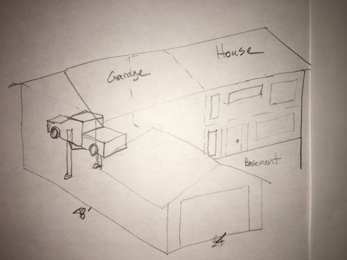

      Maybe I should design with a basement, because we see tornado's in Iowa, and it would make installing mechanicals straight forward. And design a two bedroom, with room for a third in the oversized garage.

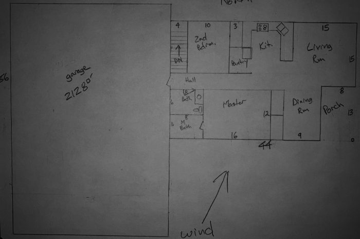

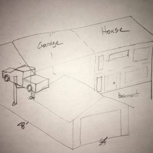

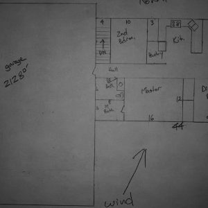

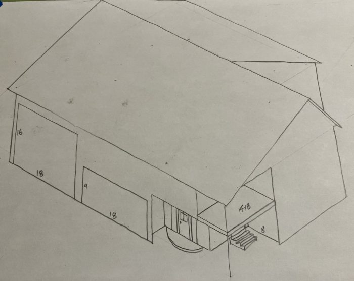

          Most homes in my area have basements, so I'm redrawing my plan at 28 feet wide instead of 38. I've never actually completed a floor plan yet as I was more focused on a simple shape and roof. The closest I ever got was on a two story. I need 14' of height for a car lift in the garage and was back and forth, but decided to use 38' scissor trusses instead of a two story. I'm on a hilltop but don't have enough elevation change to have a walkout so the basement probably won't be utilized to its potential because of the large garage size. Below is a sketch of my first design, where someone could remove the lift and add another couple of bedrooms, but I ditched the idea. I didn't like the roof/wall intersection, and the garage was too small. The second sketch has some big headers. Where can I get ideas for functional floor plans? Thanks Akos

            Mike,
            I would figure out a floor plan and house layout that works from you and work from there. Equipment and ducting can always be made to fit, no need to design the house around it.
            If you have the land, I would go for a detached garage maybe with a breezeway connecting it to the house. This way you are dealing with two separate structures and each can be designed to serve its purpose the best.

          You mentioned a detached garage because "each can be designed to serve its purpose the best" I planned on 6" Bonfiglioli walls and R60 ceilings in both, thinking even without heating , the garage wouldn't freeze using a Un-insulated slab. Un-insulated would also keep the garage cooler in the summer if I kept the doors closed like a shop I used to work in. Perimeter insulation over the stem wall would perform well, but protecting it from the mower and weed trimmers is nearly impossible, so that's the weak link and I will keep it as low as possible..
          I'm concerned about resale value, so would a detached be more sell able? Another aspect is the mobile home I'm living in sits on the only spot a walk out could work, and work very well considering the mile long view. I'm thinking maybe do the detached, and instead of investing more money in the mobile home, sell it and invest that money into a 2 bedroom home that actually builds equity.

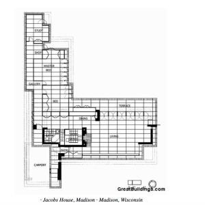

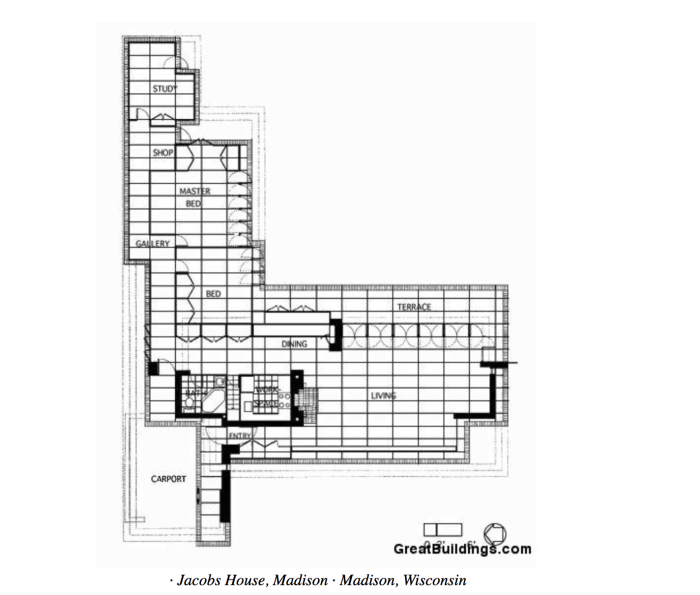

    Another possibility is a slab on grade, with only a very small basement where needed. That's what Frank Lloyd Wright did in most of his Usonian houses. Check out the Jacobs House plan and note the stair between the kitchen and bath. It leads down to a small basement under those 2 rooms. The rest of the house is built on a slab.
