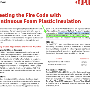

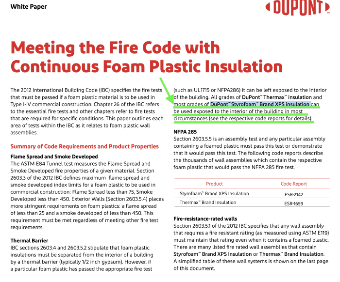

      Thermax is expensive. I read a Dupont white paper that claims its XPS boards can be left exposed too but I cannot find an XPS board with documentation that supports this claim.
      https://www.dupont.com/content/dam/dupont/amer/us/en/performance-building-solutions/public/documents/en/meeting-the-fire-code-with-continuous-foam-plastic-insulation-43-D100637-enUS.pdf
      Im wondering if that bubble wrap used on ductwork would qualify as a thermal barrier.
      I will call Noburn about their paint. There should be an inexpensive option.
