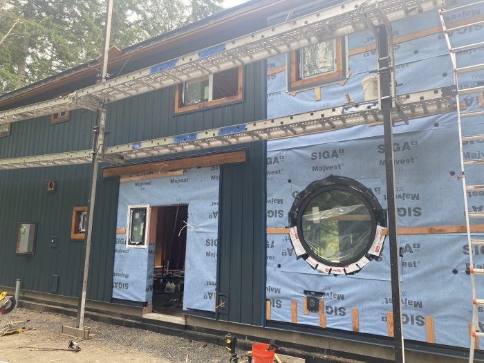

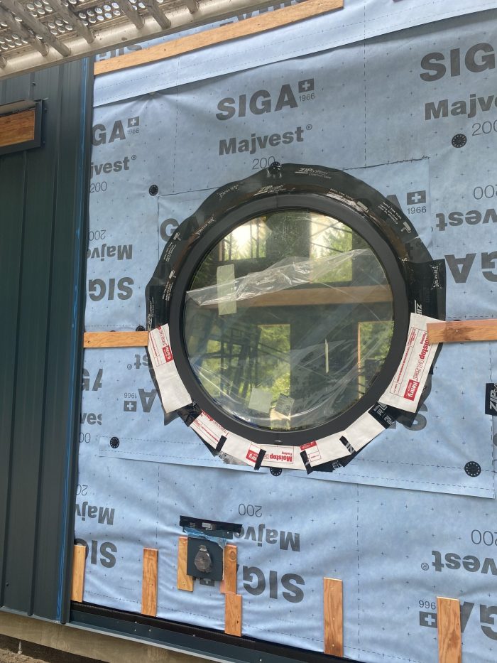

Hi all, I’m installing a “outie” round Upvc window (flush with exterior insulation), then 1/2” furring strips and vertical metal panel siding.  My original trim detail is unfortunately no longer possible and I’m looking for some guidance on a new plan!
The original plan was to first install a custom round pvc casing, matching the depth of furring…1/2” (this is already fabricated and on site).  Overtop of this would be a custom round metal j-channel (with a 1” reveal of pvc casing) that would accept the cut metal panel. Alas, my local sheet metal manufacturer cannot accommodate the profile I need on his 3d machine.
What are some other options (ideally still using the pvc casing on site)?

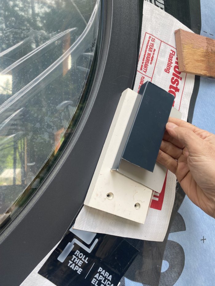

    1. AdamPNW | | #6
      Thanks Malcolm. That could work, it would need a short jamb leg to cover the panel ends right?
      If it was copper, just dreaming here, how would you attach it to the siding but keep it isolated?
        MALCOLM TAYLOR | | #7
        Adam,
        Would there be any common fasteners? The flashing ring would be fastened to the PVC under it. The cladding gets fastened several inches away. There should be only incidental contact between the two, and the pre-finished panels will have some protection from their coating, but I'm really not sure whether that's enough to rely on.
        1. AdamPNW | | #8
          Something like this?
            MALCOLM TAYLOR | | #9
            Adam,
            That looks like it would work. Maybe cover the backside of the copper with a piece of peel & stick?
  4. AdamPNW | | #10
    Great! Tape is a good idea. The L- channel should be less complicated to fabricate.
