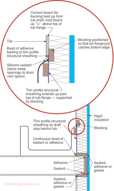

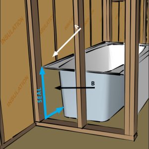

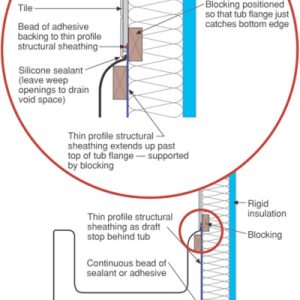

    If rigid is better overall, what material is best and does that still get installed top to bottom? Or is it possible to just install behind the tub and have the cement board and tile act as the air barrier above it (images attached)?

    Personally, I'd prefer to see a continuous product in place before the tub is installed. Trying to get a transition between the area below and above the tub using two different applications can be difficult to make a continuous air seal. You could use a thin wood sheet good, like 1/4" or 3/8" plywood and seal the seams and edges using a tape or sealant, install the tub, then cover the plywood with the tile backer. If you use a cement board as a tile backer, the cement board needs to be treated to assure it is water resistant. We've used both roll on waterproofing "paint" products like Redgard and membranes designed for tile applications (Schluter Kerdi).

    Both the tub and cement board will be fastened through the plywood, directly into the wall framing. The plywood is only an air barrier, not as an attachment point for the tub or wall finishing material.
    There are other products that will work as the air barrier, the rigid insulation idea your contractor had would work as long as it is sealed to assure it is airtight. If that is the product used, I would keep the insulation thin, 1/2".
