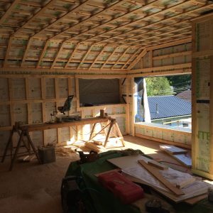

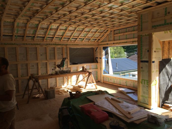

      Michael Maines | | #3
      Got it. I have cross-strapped the interior with 2-bys on a few occasions, which is enough for electrical changes, but not much else. This one's a Passive House.
      I have seen that product but I have not used it, since I only use Rockwool when cellulose or wood fiber won't work.
