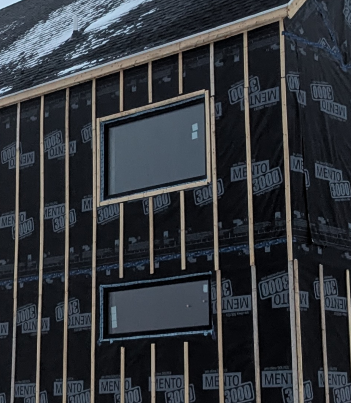

I am working through some of the siding details I should have given more thought to previously.  We have Euro style flangeless windows, set about 2″ back inside the window RO.  Face taped all around to the WRB. Then 1×3 strapping for a rain screen.  I intend to use 1×4 cedar to make an extension jamb and butt the siding against that, or leave a slight reveal gap.
All that said, as you can see, we have done most of the rain screen details already.  I’m thinking I should have put a drip cap tucked under that top horizontal 1×3.  How have others detailed a drip cap?  Attach it to the 1×3 and back tape to the WRB over the top of the 1×3?

    The rain-screen furring should all be vertical with no horizontal pieces above or below the window. The head-flashing should be lapped by the WRB, and the trim held up 1/8" above the flashing to allow moisture to drain.
    1. Tim_O | | #2
      The furring being all vertical makes sense. The framer might not be so happy about removing the horizontal ones. Shouldn't the drip edge go over top of the trim? I could tape the drip edge to the WRB.

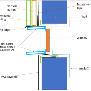

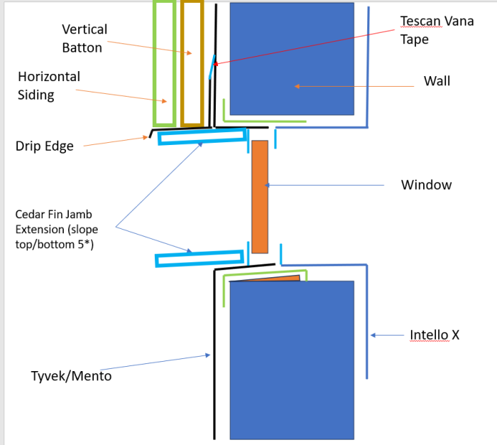

          This makes sense. I sketched up a picture in PPT, I'm no CAD jockey, haha.
          I think I need the horizontal buttons removed unfortunately, to make this work.

            Your detail is what I would do (and have done.) Malcolm is right; you can't have a continuous batten above the windows; I have seen that result in moisture problems more than once. I project the jamb extensions beyond the face of the siding since achieving a flush condition is very difficult. I leave a gap between the siding and the cap flashing.
            Another way I have done it is to stop the extension jambs at the back of the siding, and run the siding over the jambs. That requires a drainage gap and flashing between the back of the siding and the head jamb.
          2. Tim_O | | #6
            Thanks Mike, I will work with the framer to pull those off and go with my detail.
