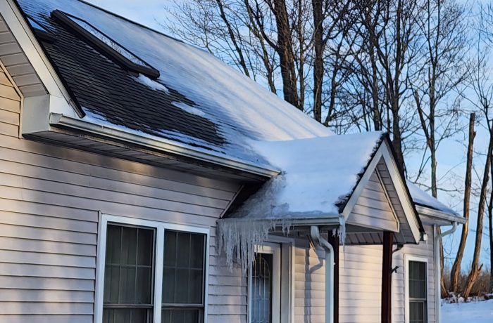

Looks like I’m unfortunate enough to have been a victim of a bad attic install gone wrong.  My roof was open-cell sprayed approximately 10 years ago.
Seems that part of the cathedral portion of the roof is deteriorating.   As it turns out, the roof is about due for shingle replacement anyway (roof appx. 22 years old), but I am now in a situation where I cannot find anyone to remedy the situation.  Plenty of companies willing to spray foam, no one has any idea how to remove.
Can’t get a roofing quote because local companies don’t know what to do.
Anyone have any advice?  I’m in the Northeast USA (NY).

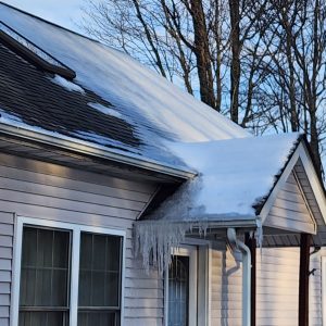

    Deteriorating, the foam the plywood the structure?
    1. closetconservation | | #5
      Looks like the plywood.
      This pic from last it snowed couple months ago..
      Some slight sagging.

    If the issue is only the roof deteriorating, you don't necessarily need to remove the foam.
    The reason the roof deck is failing is moisture buildup, so you need to add a way to vent it. Replace the damged section, strap over the roof with 2x4s on flat to create a vent channel and install a new roof deck followed by new shingles.
    Another way to vent moisture is instead of shingles is go for one of the tile roofs (slate, concrete, metal) and use a permeable underlayment under it.
    If the rot is only near the ridge, you might be able to get away by adding a diffusion vent only:
    https://buildingscience.com/documents/insights/bsi-088-venting-vapor
    In either case you create a path for moisture to escape so the open cell foam bellow is fine.
    Open cell is pretty soft, so if a large part of the roof deck needs to come out, there will be a lot of damage. In that case, mechanically removing the foam (low density stuff you can scoop it out by hand) is probably the easier. If you are not dealing with chemical issues with your foam, it doesn't need to be fully removed. You can re-insulate with batts and do either of the above venting options.
