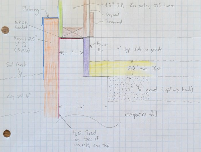

I’m having a discussion with a local architect (Colorado zone 5) about the details of insulating a finished slab on grade in a new build.  Curious if anyone has some modelling or real world experience with this.  I am using Beopt for energy modelling but it doesn’t work well for modelling slab insulation.  This question is independent of the type of insulation used,  thickness, etc, but more related to where the insulation is.
In the Slab Thermal Break detail image, some concerns:
1. the interior concrete slab is totally insulated.  But, the stem wall is uninsulated and so will get very cold at times.  Therefore the area under the slab near the stem wall will also get very cold.  Seems likely the perimeter of the interior finished concrete floor will feel cold and also require more heating to maintain interior temp and likely feel cold under food along the periphery.
2. If there is moisture in the soil sub slab, and that soil is likely going to get below freezing at times/seasonally, I wonder if that also could cause uplift from expansion.
3. Pretty serious thermal break through the base plate.  That’s going to be a rather cold line all around the house.  I also wonder if when that is cold enough it would get condensation on the inside face of the base plate where it sees interior humid air, possible mold issue over time.

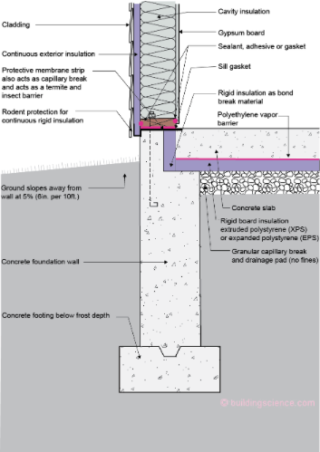

In the Footer_detail image detail:
The architect is concerned about the exterior insulation durability and moisture getting behind it.  I’m not.  The face and top of the stem wall will be waterproofed (not to mention gasket under baseplate).  The seam between the face of the stem wall and the wall sheathing will be taped/caulked (belt and suspender air sealing).  The insulation will then be applied overlapping the wall sheathing enough to cover the base plate thermal break, with flashing attached to the face sheathing (and taped to the face sheathing).  The furring strips/rain screen will be on the wall sheathing outboard of the stem wall insulation flashing .  So very unlikely issue of bulk water.  We’d likely use roofing metal material for the flashing over the insulation and to protect the face of the insulation to at least a foot below grade.
Is the exterior insulation overkill in this application?  Other concerns?  Again please don’t sweat the type and levels of insulation, could be mineral wool, could be foam glass, could be rigid foam, but more on the concepts.  Thanks
  1. Malcolm_Taylor | | #1
    mtn_hombre,
    1. To combat that I'd suggest increasing the amount of insulation protecting the perimeter. Make your ledge slightly deeper and excavate an extra couple of inches for the first few feet, so you can use more insulation under the slab there. Any reason you aren't using foam board instead of spray foam?
    You can use more foam at the slab edge by adding another layer and tapering the top so it is still hidden by the drywall and baseboards.
    2. Unless you have expansive soils there shouldn't be a problem. If there is excessive moisture inside the stem-walls, use either a rock pit or interior perimeter drain to remove it.
    3. I'm not sure the condition at the sill-plate is much different than there the SIPS panels meet, or the top, or what you find in a conventionally framed wall. If you want to increase the insulation there, replace the bottom 2" of drywall with a strip of foam board.
  2. Mtn_hombre | | #2
    Thanks for the input Malcom.
    1. Those are good points, definitely makes sense to make more room for varying insulation as you suggest. We're pricing out the gamut; foam board, spray foam, foam glass, rockwool. Also looking at the carbon footprint differences.
    2. We do have expansive soils. But we are doing an overdig and putting in dry soil, which i should have realized before making point two at all!
    3. For sure, very much analogous to conventional framing in terms of the thermal bridge, and point taken so it shouldn't be any worse any terms of condensation there. That being said, I just helped a friend with a new siding install and we found what looked like lots of black mold along the sill plate, esp on sides that didn't get daily sun load to dry it out.
    1. Malcolm_Taylor | | #3
      Mtn_Hombre,
      I misread your concern about the sill. My suggestion of a strip of interior foam would make things worse. I think good air-sealing will alleviate the risk of mold, and being un-insulated will keep it warmer and dryer.
      The reason I'm a bit reticence to suggest exterior foam is that it is a fairly involved addition to the assembly, and unless it is taken right down to the footings, the concrete still represents a thermal bypass
