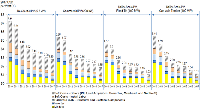

        In the same time frame residential rooftop PV has dropped in price by about 60%, making an investment in PV more valuable than risking it on the potentially marginally higher (if done right) efficiency of a ground source heat pump:
        https://www.solarreviews.com/content/page/25907/media/sunshotgoals.png
        Between those factors it a much tougher market for GSHP now that a decade ago. Yet properly running credible load numbers before specifying the system still seems to be the exception rather than the rule.
