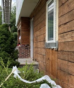

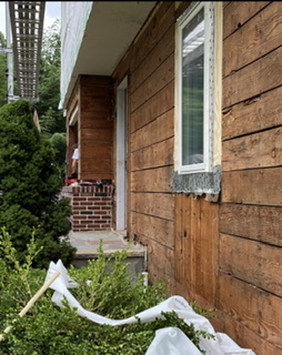

  3. smgb | | #8
    I’ve finally figured out how to attach a picture - see attached picture of the sheathing boards with gaps.
    I have decided not to use spray foam.
    Would this option #3 allow us to be “comfortable”, meaning not feel the draftiness that currently exists and be a fairly decent performing wall, assuming the details are done correctly?
    And can peel ‘n stick Henry Blue skin be applied to the back of the sheathing boards (inside the stud bays) to act as an air sealer?
