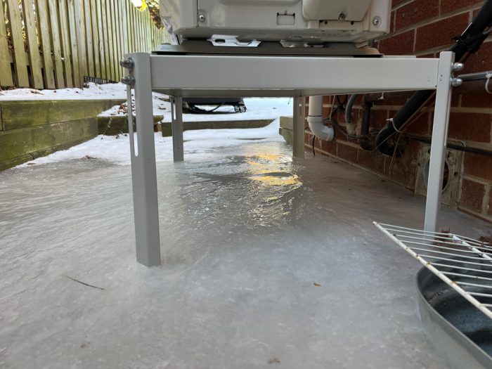

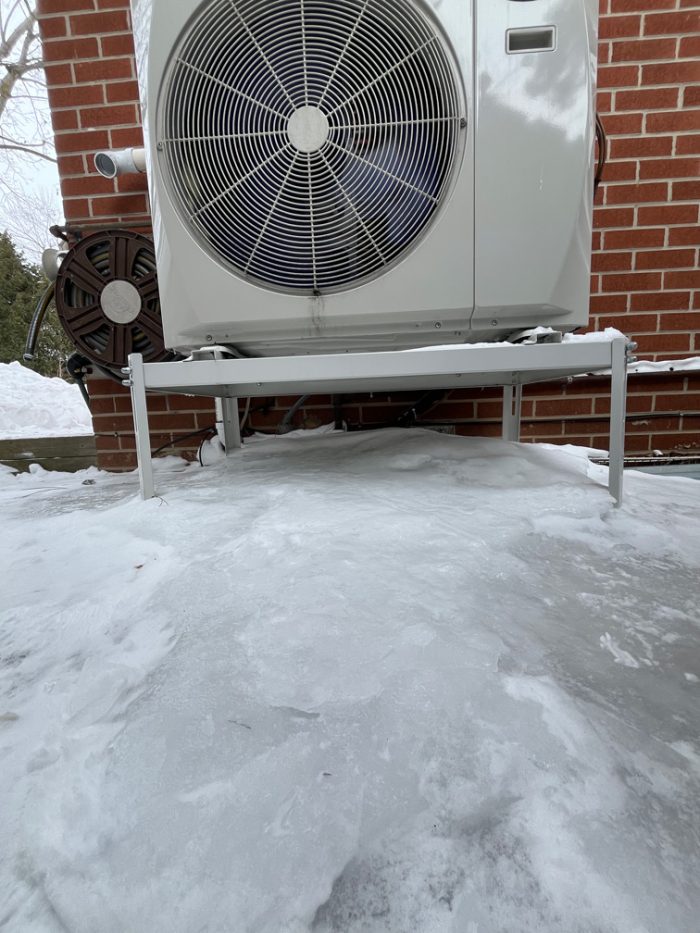

I’m wondering if anyone here has experience with solutions to manage the condensate / defrost water that comes from a heat pump? This year has been especially bad. I have a massive iceberg under my heat pump and it’s uncomfortably close to my house… The walkway slabs are sloping away from the house but it doesn’t seem to help, since the water just freezes and accumulates in all directions.

    It's funny you post that. I've never had a problem until this year either. It's the two of mine that are on the North side. The one on the west side doesn't have a problem. Ice is building up at the back bottom of the heat exchanger as well. When it defrosts, if its loose, I'll try to get some of the chunks out carefully. But the condensate is really building up on the ground underneath. Luckily we don't walk anywhere near there. A handful of calcium chloride on it everyday doesn't fix it?

      I'm actually thinking of setting up a drain hose or pipe from the bottom of the unit to the inside of the house where it can drain into a house drain. It would be good to hear from those more experienced if this is actually a best practice and how best to do it.

        8, 6 and 3 years for the 3 units. What you have is more ice underneath than me though. What bout something like a horse feed big underneath that you can remove every few days and dump ice out of?

    Lots of ice here as well in our 4th winter with heat pumps. We had to raise two of them higher from the ground this year from where our installer put them originally.
    Some thoughts: relocate the unit, dig a pit with a little gravel or maybe a deep drain at the bottom, remove some of the concrete so the water can be absorbed by the earth more easily
    I suppose piping it in to the house might work but I'd think you'd want to wrap heat tape on pipe. Probably not optimal and I wouldn't trust the fitting at the bottom of the pan to not freeze

      Thank you. I am now leaning towards the "digging a pit with gravel" solution. I wonder how deep it should be and what materials I should use. Would it make sense to line the pit with landscaping fabric before dropping in the gravel? How to ensure the water moves away from the house and doesn't migrate to the house's foundation?
      The ice berg is growing... I've had to take a chisel and hammer to it already twice. Looks like I'll need to do it again soon.
