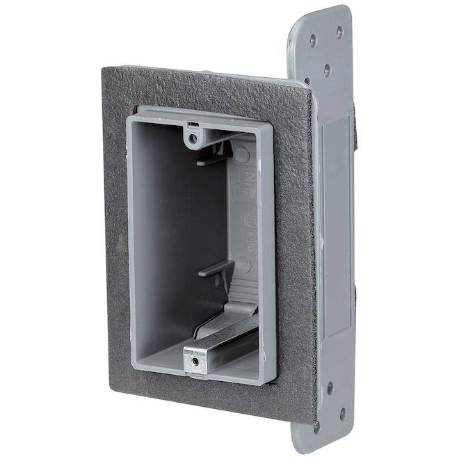

      1. RebTech | | #6
        As far as I know poly before drywall in Alberta it's required by code. They recently add a new code where all electrical outlets (inside of house) that are on a exterior walls must have plastic outlets like the picture I added. It's a insulation and vapor barrier code.
        You are allowed to use steel boxes and vapor hat barrier so long as they make a flange on all 4 side to allow a tight press against the poly and acoustic seal.
        MALCOLM TAYLOR | | #9
        Bill,
        No, it's a misconception that any Canadian building codes require poly. However it is still the overwhelming choice for an interior vapour-barrier in most of the country.
        The codes call for a vapour-barrier “sufficiently close to the warm side of the assembly to prevent condensation at design conditions". It can consist of any material less that 1 perm (our definition of a vapour-barrier, which is a class 2 vapour-retarder in the IRC).
