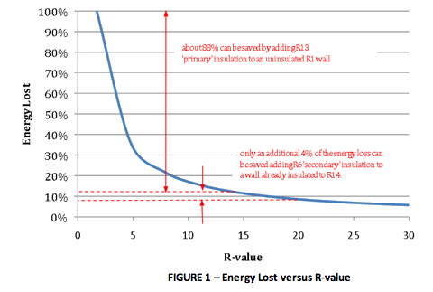

    >" The modeller comments that they increased insulation values but it didn’t change the outcome by much."
    That's probably because in a higher R house most of the losses/gains are from windows, not walls & ceiling. Going to an R100 wall or roof instead of an R20 wall & R50 ceiling isn't going to change the U-factor or solar gains of the windows. Being very selective about window sizing and even optimizing the low-E coatings used on each side of the house can change energy use by quite a bit.
    Even in foggy-dew Vancouver passive solar gains from windows matter, and moving more of the glazed area to the south face using a higher gain glass can move the needle on heating energy use. Cardinal Glass loE-180 on surface #2 combined with i-89 on surface #4 with argon fill in a double-pane glass unit results in a solar gain almost as high as clear glass double panes (no low-E), but a U-factor as low as some triple-panes. That's great for the south side, but could induce a significant cooling load if used on a significant area of west facing glass, which gets direct sun well into the evening this time of year in your area. A lower gain glass (or even no glass area) would be better on the west side.
    Even north facing windows have some solar gain, but should be used primarily for daylighting, without excessive area. Most of the year daylighting from north facing windows would be shadow-free, with no direct sun except the weeks around the summer solstice.

            Akos | | #51
            That is the challenge with designing efficient buildings. Once you get above around R15, adding extra only reduces your heat loss by a small amount. This is a good illustration of the issue:
            https://www.buildinggreen.com/sites/default/files/articles/SPFA%2520picture%25201.gif
            It doesn't really make sense to go much above R25 overall for a wall except in very cold climates.
