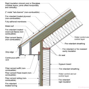

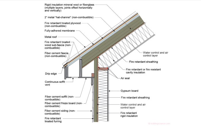

    Consider something like this photo.
    You might find this article interesting the photo is from.
    https://buildingscience.com/documents/building-science-insights/bsi-129-wildfire
    Walta

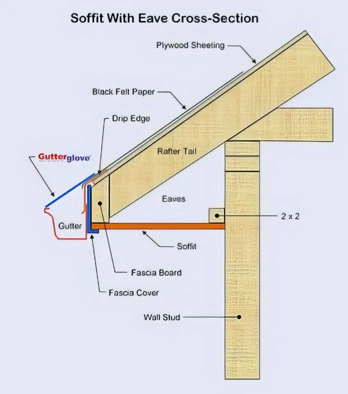

    Circling back on insulation. We have landed on Batt + Flash for above the living spaces. However, had a question on under the eaves. My architect is suggesting sprayfoam as well there, claiming filling it will help with fire. Contractor is argueing that fiberglass is fine. I'm seeing in the building science documents most of them just show as empty as long as the spray foam is capped.
    Any advantage for fire in filling the enclosed eaves with insulation and if so does it matter which type?
