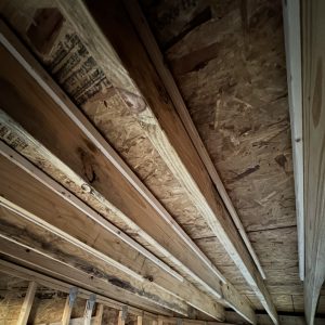

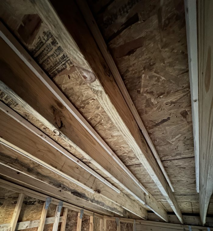

      1. shedworkshop | | #15
        I ended up going with 1x2's nailed to the rafters. Pic of the in-progress work attached. The miter saw cut idea is genius, but some of my rafter spaces are different sizes (I know, I goofed). I'll probably skip the air sealing since it doesn't sound necessary. Anyway, seems to be going well so far, but critiques welcome!
          BILL WICHERS | | #16
          There is no need to air seal vent baffles, your air barrier should be whatever is going under the rafters -- usually some kind of panel product (drywall). It's much easier to air seal the ceiling, and better too, because it helps keep moisture from getting up into the roof assembly.
