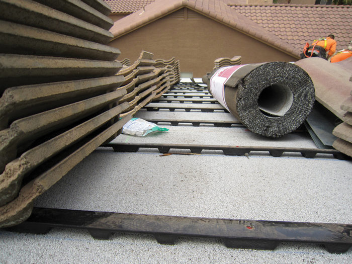

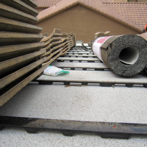

    I was thinking of your horizontal furring strips. But actually, a batten = a furring strip = strapping. These are just different words for what amounts to a 1x3 or 1x4.
    Here is a photo -- not exactly what I had in mind, but it gives you an idea how these are used by roofers. I couldn't find a photo showing the exact type of batten I'm talking about.
