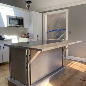

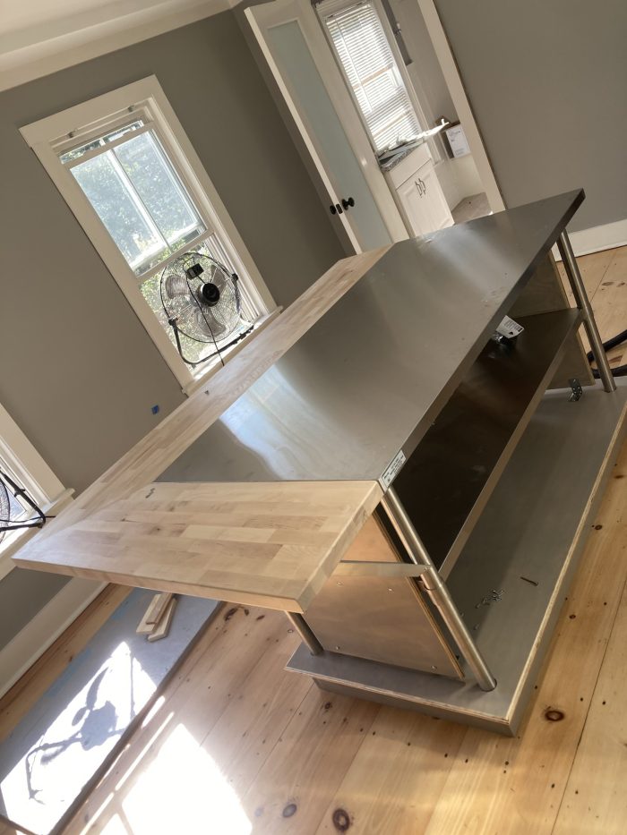

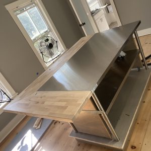

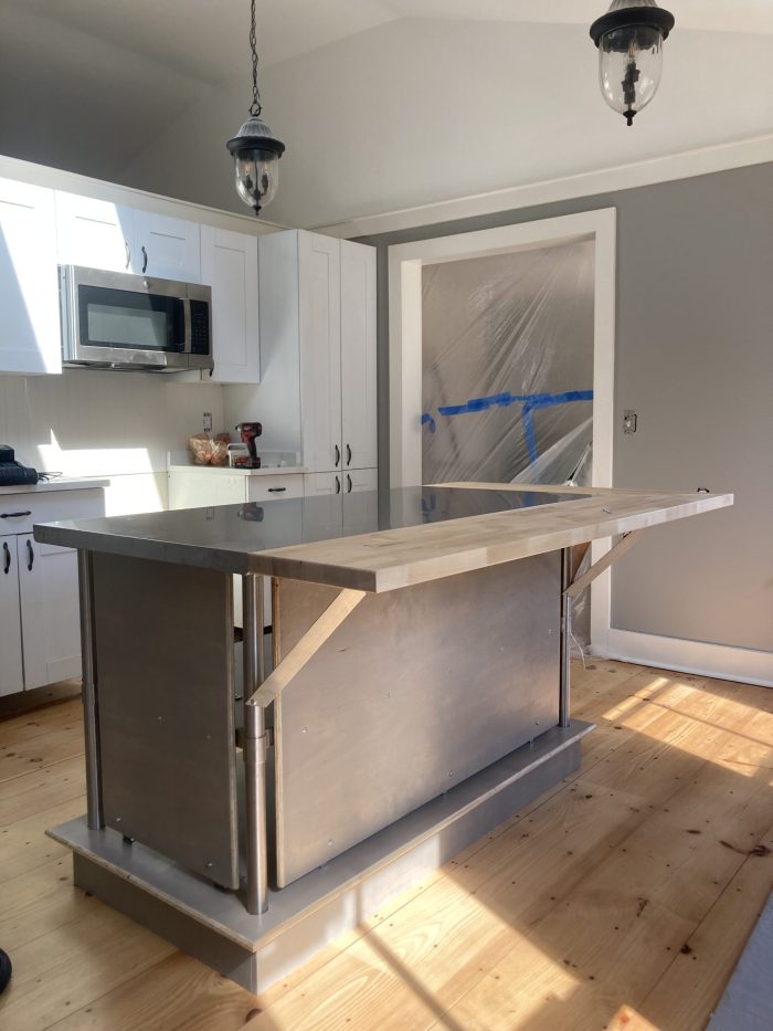

  5. climbing_carpenter | | #10
    HD and Lowes sell unfinished birch butcher block for +/- $18 sq ft. It’s the least expensive counter material I know of that’s worth installing. Most stores have in stock in 4, 6, 8, 10 ft lengths x 25 in widths. Island options too.
    Otherwise, I have a fabricator I work with for granite and quartz. Not a box store for this stuff, fabricator is much less expensive. We use remnants for bathrooms and small kitchens- that helps too.
    Box store formica is wretched, not worth the few bucks it costs.
    Also, I’ve built cabinets and tops out of commercial stainless steel prep tables- these things are inexpensive and the top will last a lifetime with nearly no maintenance.
    Here are a couple of photos. Incorporated birch butcher block into this one. Apartment grade work.
