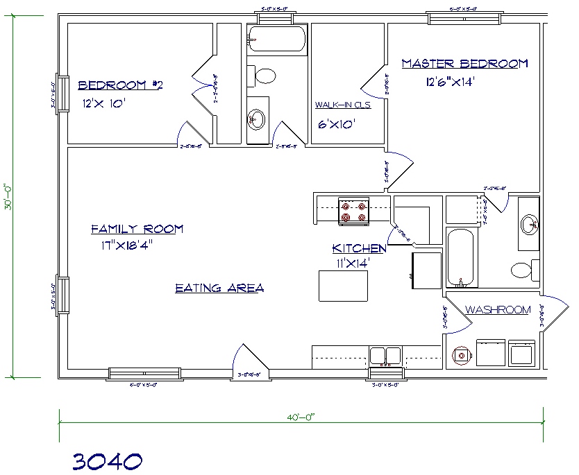

    Whew, glad I'm no longer in the floor plan stage. It's tough to get everything you want in the right place! I poked around online to see if I could find anything that got you what you wanted. Here's the closest I could find. The biggest downside is the second bedroom opens directly to the living room. There's also no coat closet at the front entrance. If you flip this horizontally you can get the garage on the west side like you have it.
    http://www.wdmb.com/images/FloorPlans/3040C.jpg

    I just wanted to say thank you to those who have help guide me along. For those of you interested I have attached my final layout. Maybe my floorplan will help someone else trying to accomplish the same. I know it's not extremely pleasing to the architects in the house but I am on a strict and thin budget. Enjoy!
  5. RMaglad | | #5
    Very nice elevations, clean and simple!
    I wonder if you could add at powder/half bath opposite of the front closet, beside the front door?
  6. drewintoledo | | #6
    Thank you Ryan for the awesome idea! I like to be outdoors and having the bathrooms at the back of the house had me a little concerned about traipsing dirt and such across the house especially if I have a party with multiple guests outside. I think I'll move forward with your suggestion.
