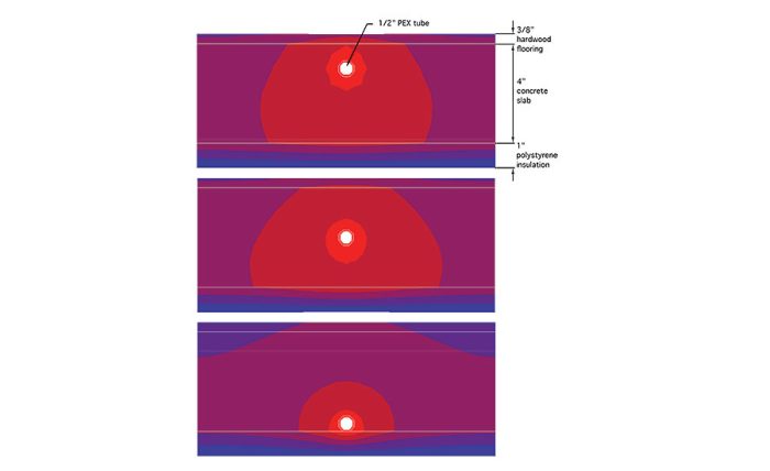

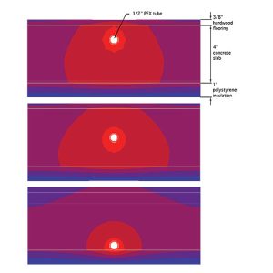

    BUT, here are my lessons learned: you gotta decrease the pex tube spacing, like 6 inches apart. This means more zones and more tubing. You also need the tubing near the bottom of the slab (as the concrete contractor suggested). Keeping it too close to the top (like I used to do for a more reactive system) ended up with distinct lines in the snow of where the tube is, and wouldn't heat the slab evenly and so it wouldn't melt the entire walkway or driveway. Water runoff and draining is also important as akos said because the standing water will refreeze and cause more of a hazard than just straight snow.

    Also attaching a resource regarding depth of heat trace/pex piping. Sometimes if it's tied to the mesh, it ends up dumping all the heat into the ground and the slab even if it's insulated. I assume you have a 4" or 5" deep slab so keeping the trace 2" from the surface w/ rebar chairs or something would be ideal. Just don't let it be at the bottom. I am sure Thermosoft has this is in their install details also.
