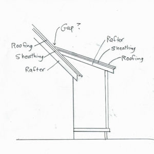

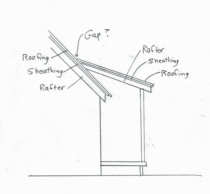

    A. Your question is unclear. Is the gap between the porch rafters and some (unnamed) component of the building? Or is the gap between the porch roof sheathing and the sheathing on the main roof? Or is the gap between the porch roofing and the roofing on the main roof?
    Unless you describe the gap -- telling us the materials on each side of the gap -- we can't help you.

  6. ladymarq | | #6
    Sorry if description gap not clear. It is the space between the two roofs which extends half way up to ridgeline.
    The outside edge at house wall plane has been closed in with sheeting & blocking which leaves a triangle of air space between the two roofs. Layers from top to bottom are porch roof = metal roof/UDL30 underlayment/sheathing/rafters then closed in gap/air space gap then old roof = UDL30 underlayment/sheathing/roof truss then my insulation at the heel.
    I'm thinking not an issue as the insulation envelope will be below & space fluctuate with outside air temps. However, any chance condensation? Any moisture that might develop inside that space would run down the UDL30 water & air barrier & hit the sheathing at the wall plane.

    Glenn,
    You wrote, "It is the space between the two roofs which extends half way up to ridgeline."
    This is still unclear. You need to use words like rafter, sheathing, roofing, or flashing -- or else we will never know what you are talking about. Maybe the sketch below will help you.

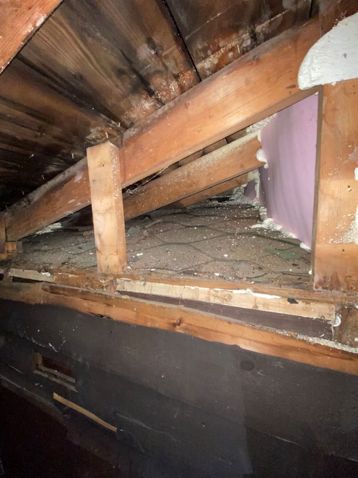

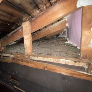

    I am really interested in this issue. I have a "dead space" located where one roofline met an older roofline creating a triangular space with zero insulation and zero ventilation. The rest of the home is sprayed with closed-cell. This "dead space" was created by part of a new roof that was added for an addition which included an enclosed porch. I am in the middle of rebuilding and finishing the porch space to full living space and opened this "dead space" up when removing some older sheathing. Any advice would be helpful. Happy to provide more pictures as well.
  9. stevelux89 | | #9
    For clarification, there is spray foam on the underside of the old roof as shown in this photo (old roof shingles visible). My question would be whether I should be concerned about this space if I were to add a wall covering this up. From the point of view of my photo, I would be located in the old porch, which is to be converted to conditioned living space, also spray foamed ceiling and walls. I plan to spray this cavity completely since it is currently open and visible, but I am aware of two other places similar to this one on my home, but neither abut an outer wall, just the non-sprayed underside of the roof.
