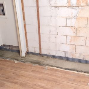

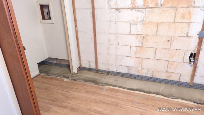

I would like to know the install method if one wanted to both insulatate and apply moisture barrier to basement drywall, before hanging the drywall sheets?  Also, is there specific code requirements for Prince Georges County, MD in 2025?  This install should consider a very humid climate in the summer, and colder temps in winter time.  I am mostly curious on how to install both a vapor barrier and foam board insulation before putting up drywall.  Thanks.

      Thank you very much and that helps a lot. My strategy now is using membrane plastic vapor barrier directly on basement wall sealed with caulk or double sided construction tape, then purple R-3 foam board insulation (1/2 inch), tape and seal cracks on all sides, then 2x4 stud wall with mold resistant drywall. Thanks again, and hopefully this will work and I will consider your suggestions also.
      Justin

            Thanks guys! One last question, is there a "double vapor barrier" danger with both plastic and foam board install, like plastic to the wall, then foam board (r-3) over it? Some say it can trap moisture in between. I had basement waterproofing done along the entire edge trim so I'd like to tuck plastic vapor barrier into the 4" trim riding up from ground as a catch. If we put a dehumidifier in the basement rooms it shouldn't be much an issue I am guessing.
            DCcontrarian | | #13
            If the materials are impermeable there's no danger of trapping moisture. The double barrier is only a problem with permeable insulation like fiberglass batts or blown cellulose.
