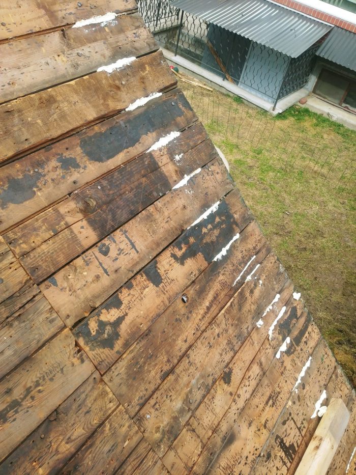

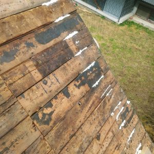

        T&G leaks not just up through the boards but also along the T&G grooves. Where the T&G goes over your outside wall, all those small gaps between the boards add up to a pretty big air leak. Common to see spider colonies between the boards in that location as there is so much airflow.
        With a retrofit, the simplest way to seal it up is to drill a hole above the top plates (can be done from the inside if careful, easier on the outside) and inject flex foam in the gap. See picture of where you need to air seal.
        If using peel and stick, no need to tape the seams of the rigid.
        I would go with an acrylic based peel and stick such as VP100 or VaporDry SA , the common ice and water with modified bitumen can smell and sometimes it can interact with sap in the wood causing it to ooze.

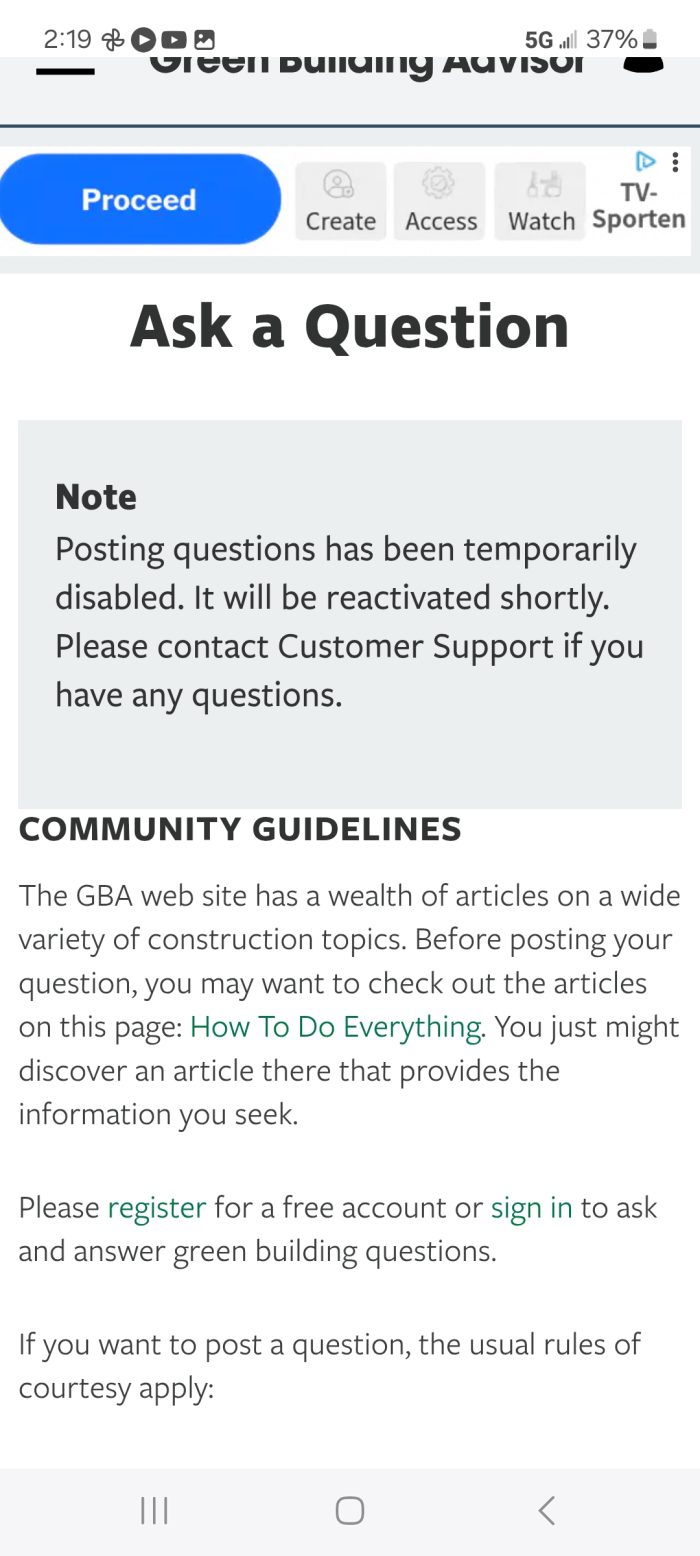

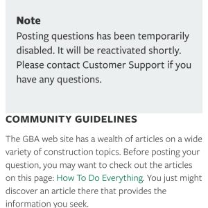

        1. idahobuild | | #5
          Anyone know how to get accounts fixed? My account won't let me post new QA questions. Grrr.
          1. JustusM | | #6
            I'm having the same problem
            Akos | | #7
            There was a big spike of spam recently. I believe the moderators disabled new posts until they figure out a workaround.
