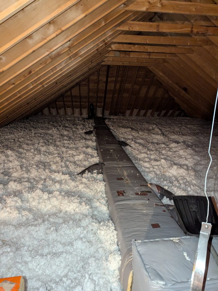

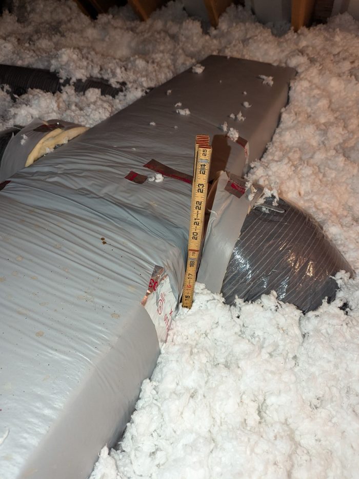

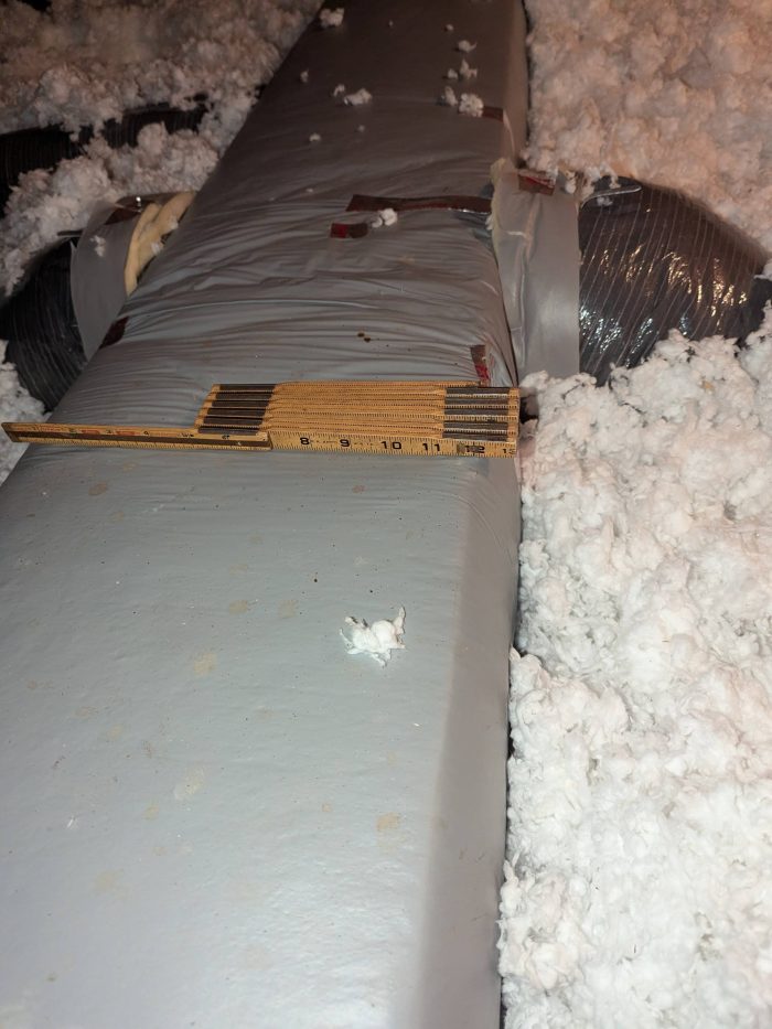

I have 40 feet of square metal ducting in an attic. It is subject to extremes of temp and humidity.  I am located in climate zone 5A, southern NH.  Currently it is insulated with a pitiful 1/2″ of fiberglass wrap and vinyl.
The ducts sit 6″ above the ceiling joists. Total distance from ceiling drywall to bottom of ducts is approximately 12″. The duct is held off the ceiling joists by 2×6 spacers. and metal ties.
There is plastic vapor barrier on the attic side of the ceiling drywall.
FG batts combined with blown in FG insulation fills the space from the ceiling up to the underside of the ducts.
I intend to strip the existing insulation and seal the ducts (which was not done during installation).
I then want to make a 3 sided structure of 2″ foil faced polyiso insulation board over the ducting, anchoring it to the ceiling, which would be the 4th side. I will seal the joints between the polyiso boards with gap and crack foam. This would make a box that brings the ducting into the conditioned space of the house and isolates it from the unconditioned attic.  In effect, an upside down soffit.
I intend to leave the present attic insulation in place under the ducting when I enclose it.
The 2″ polyiso will be R-13+. The recommended R value for attic ducts in my climate zone is R-13.
My primary question is, can I use 1″ polyiso board to fill in the space between the ceiling joists, beneath the ducting? The 1″ is only R-6 but it will be backed up by the insulation that is under the ducts now, that I will enclose. I’m not sure what the effective R value of that arrangement would be.
My main concern is to avoid condensation on the surface of the Polyiso board when running the ac on a 72 degree dew point day.

    To avoid condensation you need a sealed vapor barrier on the exterior of the insulation. You can see in your photos that the existing insulation came preinstalled with this. Moisture will want to condense on any cold surface that it can reach, like your metal duct when it is in cooling mode, so however you insulate it you want to be sure to have a vapor barrier out beyond the point in the insulation where the dew point will occur (typically the exterior of hte insulation). If you use polyiso, you probably want to use foil faced polyiso (with the foil on the exterior acting as the vapor barrier) and tape any seams/joints with aluminum duct tape.

      Yes I wrote that I will use the foil faced polyiso. Without taking the current insulation off I'm not sure of the extent of leakage. However, the fittings for the takeoffs from the main trunk to the the branch flex ducts were not sealed at all and there were a lot of gaps between the bent over tabs that attached them to the main duct.
      As I said, the main question I had was whether the 1" polyiso was good enough R value to block off between the joists, beneath the main trunk. I may have to make a drawing to make clear what I'm asking.
