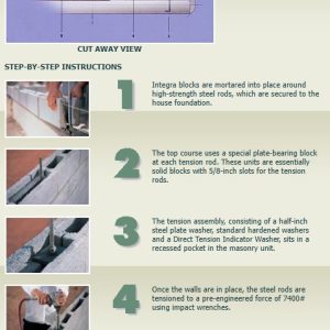

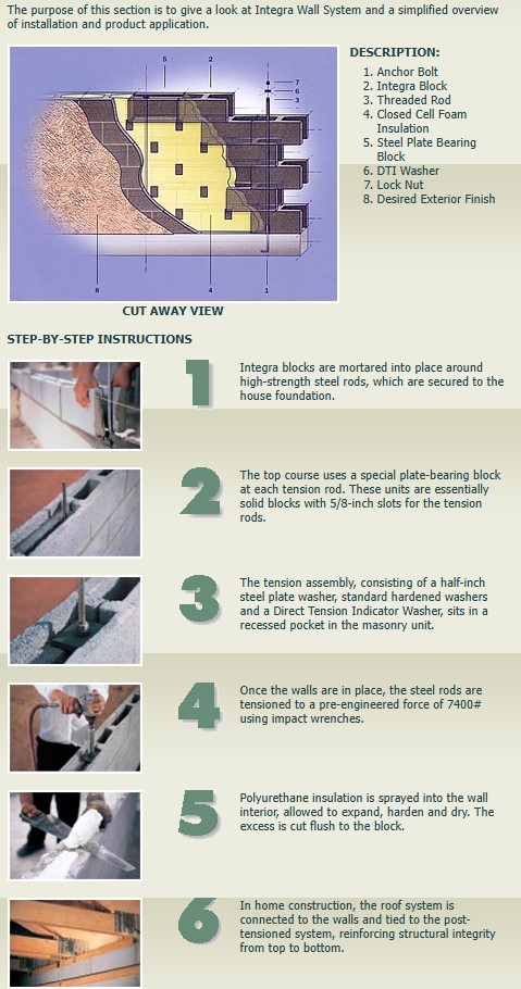

    1. begreener | | #2
      When I worked at FoamTech (long time ago) we also had a post-tension, CMU block that we would inject with polyurethane foam called the Integra Wall (Old Castle parent - no longer available)...
      It wasn't completely thermally broken, but the foam was applied in the field rather than the factory (kind of like the concrete is for the "Perfect Wall").
      https://www.integrawall.com/introduction.htm
      re: "the wood on the interior" it's actual shown on both sides like a true SIPs panel, but that reminded me of the Gablok product in Europe
      https://www.gablok.com/

    1. begreener | | #4
      From the company I used to work for that had a similar "post-tension" block system with poured in place polyurethane foam ...
      From "Energy Design Update" newsletter (by JD "Ned" Nisson)
      http://www.foam-tech.com/products/integra_post.htm
      excerpt:
      "Post-tensioning should not be confused with conventional reinforced concrete, which uses reinforcement bar-embedded in grout to provide strength. Post-tensioning employs a completely different engineering principle. The purpose of the tensioning bars is to compress the blocks. Once compressed, the inner and outer block faces carry the full load."
