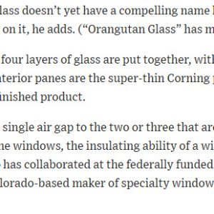

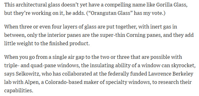

      Here are some of the details in the article:
      "These new three- and four-pane windows can be even better insulators than the walls around them, but cost only about 20% more than standard energy-efficient windows. "
      "Enter Corning, maker of the thin, tough Gorilla Glass that has helped make possible today’s mobile devices. In order to win over Steve Jobs and land Apple as a client when it first started making iPhones, Corning offered Apple a fresh twist on its existing process for making glass for LCD displays and other applications, which yielded a new kind of chemically strengthened glass."
      "When three or even four layers of glass are put together, with inert gas in between, only the interior panes are the super-thin Corning panes, and they add little weight to the finished product.
      When you go from a single air gap to the two or three that are possible with triple- and quad-pane windows, the insulating ability of a window can skyrocket, says Selkowitz, who has collaborated at the federally funded Lawrence Berkeley lab with Alpen, a Colorado-based maker of specialty windows, to research their capabilities."
