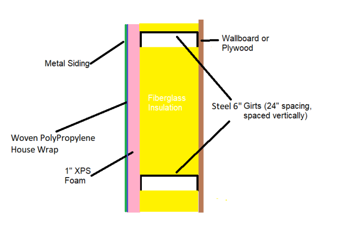

Steel building, Climate Zone 4a, steel girts/purlins 6″ thick.  Wall stackup from outside is:   Steel ribbed siding, woven house wrap, 1″ XPS, Girts/Fiberglass batts, wallboard.  (See picture).
I realize that the 1″ XPS acts as a vapor retarder so I want to be careful about a vapor barrier toward the inside of the building when installing cavity insulation.  At one point, someone told me that Kraft paper vapor barrier insulation was ok to use but avoid poly sheeting vapor barriers.  Is this true?

    How much R-value are you aiming for, or what will you be using the building for? Thermal bridging through the steel girts will significantly undermine any insulation you add between them. With the steel siding being an excellent vapor barrier, you certainly don't want poly on the inside. In climate zone 4, you only need a class III vapor retarder, which can be provided by a couple coats of latex paint.

    You are right, going from memory, the steel girts in my wall will kill about 60% of the insulation I put in the cavity. It is a 6" girt, so R19 turns into R7. Adding the R5 from the XPS, I am looking at around an R12 wall assembly.
    The main reason for the XPS on the outside was to provide a thermal break from the steel siding to the girts, as well as provide an air barrier (it is glued and taped), as well as a "semi" permeable vapor barrier.

      The 2024 IRC allows you to use a "responsive vapor barrier" over a 2x6 wall in climate zone 4 if you have at least R-5 of continuous insulation. I believe the kraft facings would meet the definition of a responsive vapor barrier. The 1" of XPS should give you the R-5 continuous. And at 6", your wall cavity is a bit deeper than a 2x6 stud wall, but that shouldn't matter if you are putting in batts intended for 2x6 walls. So, I think kraft-faced batts would be borderline okay if you're turning the building into a residence. If it's just a low-occupancy shop, then no concerns at all.

            Kraft facing is a class II vapor retarder, not a vapor barrier. The building code categorizes vapor retarders into three classes. Class I vapor retarders, such as poly plastic and sheet metal, are the most effective. Because they allow almost no vapor to pass, class I vapor retarders are sometimes also called vapor barriers.
            In climate zone 4, the IRC (which is intended for residential occupancies) requires framed walls to have a class II (ex. kraft facings) or class III (ex. latex paint) vapor retarder on the inside. A class I vapor retarder/vapor barrier/poly is not permitted.
            The IRC also doesn't permit you to have a class I vapor retarder on both sides of a framed wall because any water that got in wouldn't be able to dry out. Since you have sheet metal on one side, that's a second reason for not using poly inside.
            I think kraft-faced batts would be fine under painted drywall. With plywood finish, I would choose unfaced batts because the combination of kraft facing and plywood might not allow enough drying.
