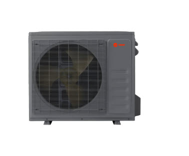

AC side of 14 year old Amana gas furnace/AC was pronounced dead in November.  I have solar panels so I’m jumping off the cliff and going heat pump (and replacing gas water heater with a Stiebel Eltron heat pump water heater).  The useful quotes I have are for a Lennox cold climate system (EL21KLV, proprietary communicating everything) or a Trane 6-speed (SEER 17.5 with Honeywell zoning).  The Trane dealer bad mouths Trane zoning that I’d have to use if I went up to a Trane XV18 variable speed, saying he’s had to pull them out.  I’m in Raleigh, NC, CZ 4A (one county over from 3A), 2050 square feet, two-story, completely straightforward upstairs/downstairs zones.  I got an independent Manual J a few years back.  It said I need 3.5 tons as is and 2.7 if I make some air sealing and insulation improvements (which I’m doing); so everybody is quoting 3 tons.
Every manufacturer seems to have lovers and haters.  Many, many people say it comes down to the install; these are 4.9-Google review dealers.  Nonetheless, my gut is calmer considering a Trane over a Lennox having read of parts-availability issues and the decade-ago class action against Lennox.  Six-speed Trane with so-so 17° performance, better Trane the dealer doesn’t want to install, or go for broke with the Lennox?  Surely Trane can manage two zones in 2025?

    Instead of zoning consider making it a second system. It will cost more but you gain redundancy. Sooner or later when something fails you will still have 50 % capacity.
    I think it is a mistake to ignore the installers reconditions and push them someplace they are not comfortable. Find a contractor who likes your plan or change plans.
    I say forget about the fake Google reviews talk to you friends and neighbors.
    The only thing I don’t like about my Rheem HP is that the fan blows out the top like the ones you are considering. When the conditions are right water from the roof drips on the stopped fan blades and freezes. Some times it prevents the fan from starting so I get no heat other times it spins but is unbalanced and shakes the unit violently. My next unit will be an Asian design with it sideways fan connected to a normal air handler.
    You did not mention back up heat strips do you have the capacity in your electric service for them?

    I'm also partial to the Asian style outdoor units plus these have a much longer track record. I would see if there is a local carrier installer that can quote you a Carrier 38MURA / 40MUAA combo. Those come in two flavors, make sure they spec the high heat unit. The only difference between the two is one letter in the model number so easy to mix up and the low temperature output is significantly different between them.
