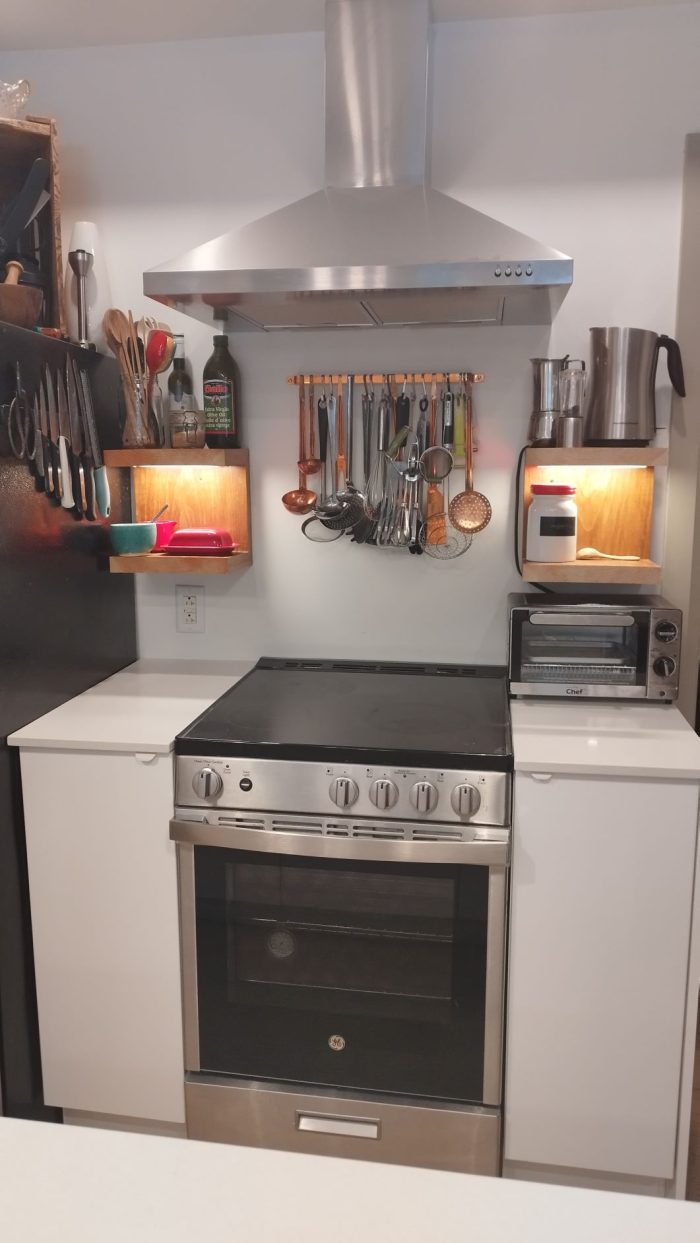

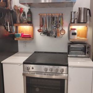

      Akos | | #6
      That is a much better plan.
      Here is one with a 30" hood over a 24" stove. Not the best designed hood as it has no capture volume but still works way better than a downdraft one.
