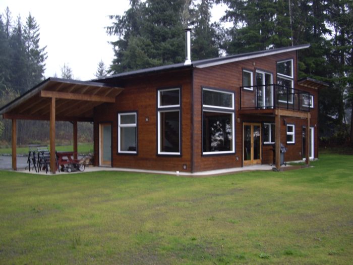

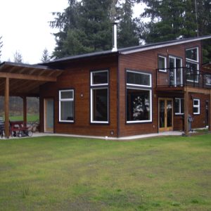

    What I did on this house and several others is install 2"x blocking between the rafters that is 1 1/2" shorter than them, and use a piece of U-shaped perforated flashing to fill the space above. I keep the the blocking out far enough that the cladding can butt up against the bottom of it. That avoids there being a ledge which accumulates dirt and bird nests.

      MALCOLM TAYLOR | | #3
      kewilli6,
      Excuse the window placement. The client and builder got together once the design was complete and made a bunch of changes. I have mixed feelings about how it turned out.
