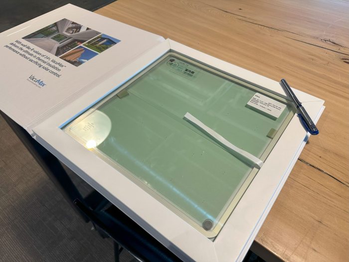

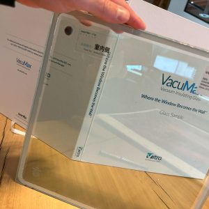

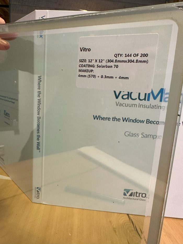

    We had a rep from VacuMax come through our office relatively recently...
    https://www.vitroglazings.com/products/advanced-glass-applications/vacumax-vacuum-insulating-glass/
    They've got it highlighted on at least one built project on their website. I agree with all above that it seems too good to be true, but it's a darn interesting idea if it can be pulled off successfully and can remain sealed for a reasonable length of time. The sample they left in our office is pretty slick, and you can barely see the standoffs that separate the glazing panels.

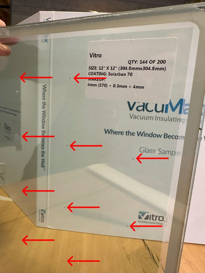

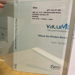

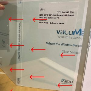

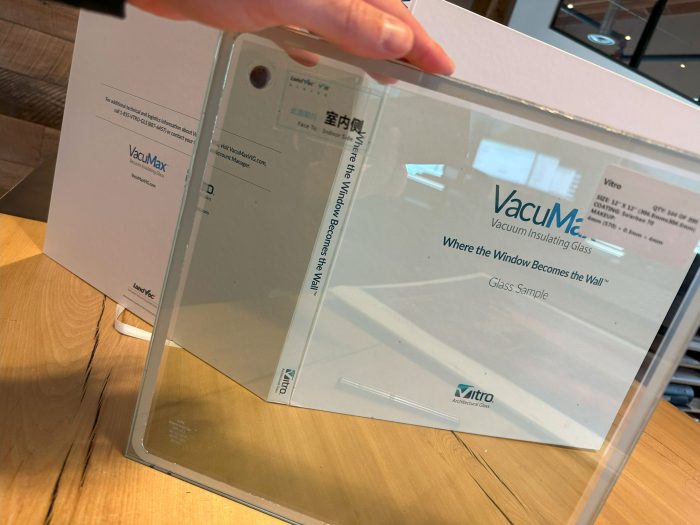

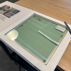

      1. paulmagnuscalabro | | #19
        Oberon & bccade,
        Check out the photos of our office sample...
        You can definitely see them (and I totally get how for some people would never be able to unsee them), but they're fairly subtle depending on what's behind the glass, viewing angle, lighting, etc. The sample is from VacuMax.
        There is a definite green tint to the glass; I assume this could be dealt with via a different glass spec?
        1. oberon476 | | #20
          I have had the opportunity to see examples of vac glass from a few different manufacturers - even had a chance to see a couple "under construction" - but haven't seen the Vitro version in person. Looks pretty good in the pictures, thanks for those.
          Per the green tint I am guessing that the samples probably have a lowE coating inside the vacuum space. Since Vacumax is a Vitro product I am also guessing that it might be Solarban 70 a triple silver coating, also from Vitro, that has a distinct green appearance.
          I don't know if there is any technical reason for using SB70 (again emphasis on guessing) if they did for the samples, but if there is no technical necessity then the Solarban family of coatings does come in a variety of shades and hues so seems like there should be options in that area.
          1. paulmagnuscalabro | | #21
            Can confirm, the coating is Solarban 70. Not sure if it was required for some reason, or if it's just what they went with for samples.
