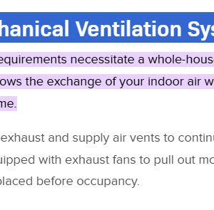

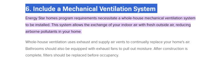

The municipality where we are building a small home (1000 sq ft on 1st floor; 450 sq ft on 2nd floor) required Energy Star (ES) certification for a CO. Our ES consultant says we need makeup air for our electric kitchen stove, but I am reading online (and on Green Builder) that makeup air isn’t required for a range hood over 250cfm, which is what I calculate we need. Please provide some input on this requirement.

    I think you are confusing make up air with the ventilation requirement. It sounds like you will need a HRV to make this requirement you may also need make up air if you have a large range hood.
