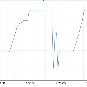

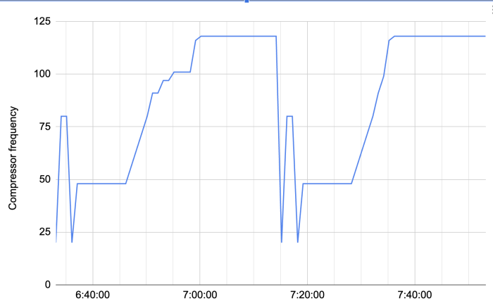

Ducted Mitsubishi Smart Multi (MXZ) heat pump and both the power usage and the duct temperature in supply next to blower drops for 15-20 minutes with each defrost cycle. The behavior is the same at any temperature from -10F to high 30s F outdoor temperature. Fan on high or low I also see the exact same behavior and same also when defrosting every 40 minutes or every 150 min.
“Officially” the defrost cycle is a couple minutes but reality is 20+ minutes of no to low heat. Everything I have read from Mitsubishi and other companies with respect to defrost is that it should bounce back to pre-defrost output quickly.
My local DSG reps and Mitsubishi tier 2 support who have maintenance tool data tell me everything looks normal with the unit.

    That doesn't quite look like defrost. During defrost you would see the power first drop to 0, back to near full and back down to 0.
    That looks more like cycling.
  2. Dave46 | | #2
    I agree that it looks like cycling but it is 100% a defrost cycle followed by 10 minutes at 48Hz. Others with Mitsubishi Smart Multi units have shared similar power cycling behavior. Here is the compressor frequency change chart during two defrost cycles from mtool data.
    Akos | | #3
    Ok. It looks like defrost than ramp up to low speed to reheat coil and see what the room load is. After the 10m at 42hz, it starts its modulating bit.
    The defrost cycle is only the bit where the inverter shuts down/restart/shut down. It is not that long.
    I guess they could have done a bit better controls and go back to the operating point before defrost instead of this.

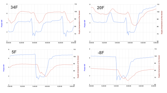

    1. Dave46 | | #4
      No clue about their design strategy but the end result is a nearly 40-50% heat output capacity loss on high humidity days with frequent defrost compared to low humidity days.
      I don't understand how this is normal as their design book indicates a 5% defrost capacity loss at temps under 25 or 20F.
      These do not seem like they are designed for New England with lots of cold and high humidity days.

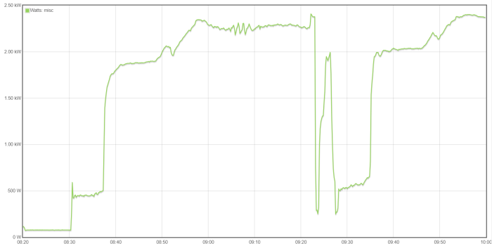

    Where are you getting those graphs? How are you getting all of this data? I have two new Mitsubishi installs that I'd love to see how they are performing, even though they seem to be providing extremely good comfort.
  6. Dave46 | | #8
    I really believe these units should be providing real time info on energy usage and performance but they don't.

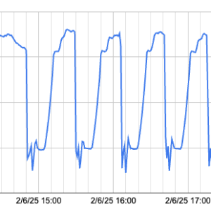

    I installed an emporia vue energy meter to get per min resolution (or higher for past few hours). I also installed a high resolution thermometer in supply duct near blower to get high resolution temp and airflow and can calculate delta T and cop. It is data logging but not web enabled so takes a little work. Also have outdoor temperature/humidity weather station. Mitsubishi logs or at least measures almost all of this information but doesn't make it accessible.

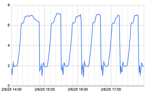

    I don’t like the shape of those graphs. What I see is a compressor running pretty much at the 2/3 or more of capacity with ever increasing pressure and with very little to no modulation. Something. Is off methinks.
    On defrost cycles- in humid weather around freezing a defrost every 45 mins is about right. At single digits outdoor your defrost should be at least roughly every hour and a half of running.
    But as I said- the overall graph is off.. you should see a ramp up, followed by a step down to a flat portion and then downslope once the set point is near until it shuts off. Do you run your indoor fan on "High"? Maybe try "Auto" just to see if the compressor will modulate better. It is not necessary more efficient on "Auto", but at least you will know system can modulate.
    The pressure spikes before defrost are typical and correct though. Once the outdoor exchanger plugs up with ice pressure spikes and defrost is initiated. So defrosts look alright. I am surprised of the slow ramp up after the defrost though.
    Overall, defrost looks ok, frequency at lower temps should be less.

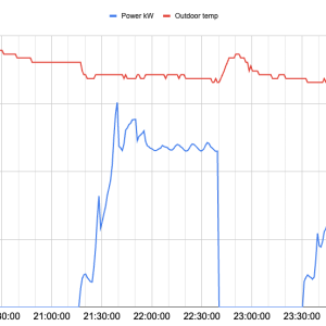

    Do you have a power graph at say 40f? This is when direct vapor injection is not active so you should see very low (relatively speaking) consumption and good modulation...

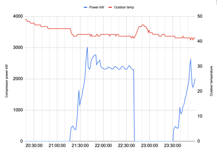

  9. Dave46 | | #12
    Here are a few hours with temps in the low 40s showing power usage. Have some actuall run data from mtool on these days and the compressor ramps up around 50 Hz.
    As far as I can tell the reason it doesn't modulate lower is that the supply air target is 100F with a minimum delta T over 30. Heat output at minimum is significantly over my load.

      Those graphs at warmer outdoor temps look alright... There is some modulation taking place and power consumption is in line with my expectations.
      This must be a larger home as this behavior is typical for a slightly undersized systems- they will work alright at higher outdoor temps, but run without much modulation (and higher than normal energy consumption) when the direct vapor injection cycle operates below 30-40ish outdoor temp.
      Beyond the speculation above - Ask the tech to check if there is a firmware upgrade for the outdoor and indoor units. Reduce indoor flow by running fan on "Low" or "Auto" and see if the system behaves better.
      I believe all is good actually with the unit if it is slightly undersized and given a large heat load... if you dont count the slow defrost recovery which might be an older firmware on the outdoor unit.

  13. Dave46 | | #19
    I agree on the emporia Vue and a weather station as the places to start. Wish it was easier.
    Here is what performance/energy usage looks like in the mid 20s with light snow or high humidity. 7 defrosts in 4 hours and output low enough each hour that it cannot recover a degree if it tried.
    Just 20 minutes with power draw over 2kW then 13 minutes of defrost/defrost recovery. Only 14minutes with draw over 6kW.
    Low humidity steady state would be about 3.5kW according to past data.
