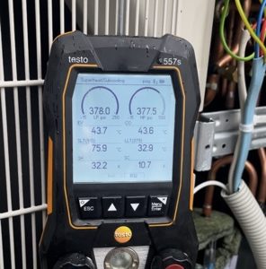

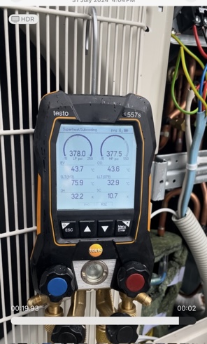

        1. Darren_1 | | #9
          The unit does tell you the subcool and super heat, but im not sure how accurate that would be. It was telling me subcool was around 1c and discharge superheat from 20-40c. They come pre charged for a maximum lineset of 30m, we are within that length. The charge was pulled and replaced twice, the charge has always been correct. Remember exact same issue was on 2x zm71 units and 1x zm140
          Unit, with Mitsi testing one of the ZM71 units in their workshop with the same freezing results. They also ran a third brand new ZM71 in their workshop with “inconclusive” results, they then decided to send me an M100 and that works flawlessly.
          1. freyr_design | | #11
            Those numbers seem very off and would indicate low refrigerant or restriction in your refrigerant line. I dont know about you other unit, but maybe it’s a common component causing the issue. Since both numbers are off it seems like it’s not the fan
        2. Darren_1 | | #10
          Here is a picture of gauges from 6 months ago. If I remember correctly, the pressures struggled to climb above 300 until the fan sped up. Once the fan was up to speed the temps and pressures were within spec if I remember correctly.

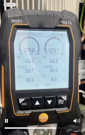

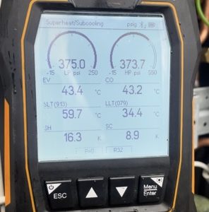

          2. freyr_design | | #13
            Yes I’m not saying it’s for sure the charge, it’s just almost certainly not the fan. When you increase your fan speed you may be melting the frost but you are exacerbating the superheating. You want that number in the range of 15, not 30-40. It could well be a software issue, causing the eev to close to much or maybe the filter is clogged, or something along those lines. A good technician should be able to diagnose these one at a time to figure out what the issue is.
            The unit is probably throttling the fan because it is showing such a high superheat
  4. Darren_1 | | #14
    Here is another picture of the gauges after it was running for a bit. If its the charge then Mitsi have pre charged them all wrong and the charge weight on the side of the units are wrong. We ran it without the filter and in the ceiling with the plenums removed. Currently the bigger ZM140 unit just has the ceiling unit hanging in the ceiling without the plenums or ducting, that is how I tested it in the above video.
