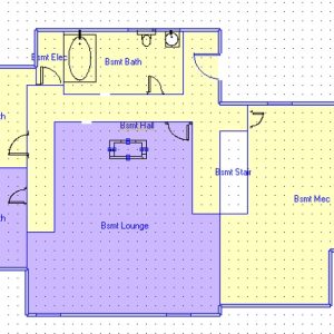

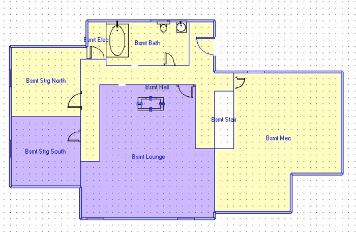

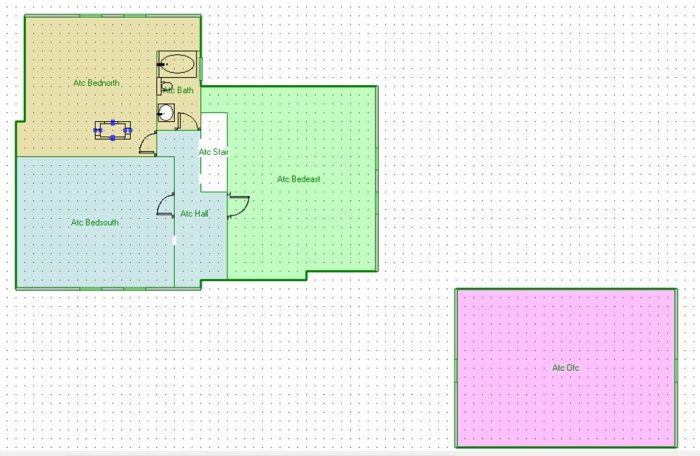

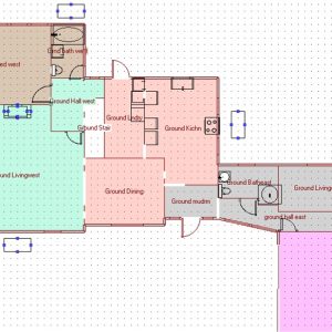

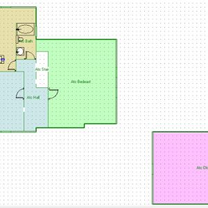

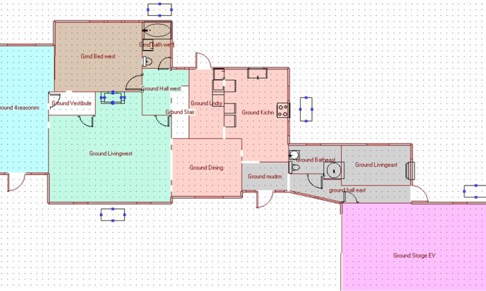

  8. anonymoususer | | #14
    Thank you, Akos. Im attaching floor plan for each of the 3 levels: finished basment, ground, attic. Pls note that the rooms labeled as "basement lounge" & "ground living east" are in reality, bedrooms. Certain adult family members are not willing to keep bedroom doors ajar at night, nor to have any sort of opening in their bedroom wall--not even small & high up--that would open it to a common area. So I see no solution other than to place a head in each of the 6 bedrooms. Smallest head mitsubishi offers is nominal half ton. On floor plan, the different colors show the rooms to be heated by a single head. The 4 blue rectangles at ground level show potential compressor placement. A licensed mech engineer who works for my local mitsubishi diamond dealer, plus a separate independent licensed mech engineer, were not able to figure out how to duct this house. We did purchase ceiling infrared panels for small rooms such as each of the 4 bathrooms, plus each hallway. We have not installed them yet but, if they keep us warm, we may also buy for other small rooms such as laundry and vestibule. I think it would be hard to place ductwork because the basement level has VERY low ceilings. Attic level has cathedral ceilings; no attic space that an air handler would fit in. I was thinking 4 compressors? Each one would serve the handler in the room closest to it at ground, basement, and attic level...? Thank you
    1. sam_l | | #15
      That is quite a bonkers layout. How is it heated now? Just electric baseboard?
      I think you might have to head the direction you are headed, I had a similar but less difficult conundrum, and ended up with 2 compressors, one on the E and W side of the house, and 5 heads (will be 6 when I redo my basement). Bathrooms are heated with suntouch in floor radiant on a schedule, which does well and is comfortable. Halls are heated by their adjoining rooms, and laundry/storage rooms are heated with small electric baseboards set very low (58F right now).
      One thing to consider is if you can try to keep the heads on a similar floor, so if you could do the three attic rooms on one compressor you'd be better off, otherwise you'll be overcooling the basement in the summer, and overheating the attic in the winter. That might mean a few longer linesets, but simpler operation. For places with very different loads, like the basement, you might still want to do a 1:1. Remember that you can make a rack and stack two 1:1s on top of each other in the same space as a normal larger multisplit, with the same amount of lineset run. I'd prefer that over a situation where you have, say, a 9k in the attic and an 18k in the basement which would be a recipe for poor performance.
      I'd also recommend doing this in phases. Figure out the easiest spots to do first, get the units in and running, and then see how things are feeling in the other spaces before then adding another multi or a few 1:1s to fill in the gaps.

  9. Expert Member
    Akos | | #16
    That is ugly but doable. Which way do your floor joists run? Any big pocked beams in the basement?
    I would put a larger ducted unit in the basement mechanical room with a supply trunk along the hallway ceiling. From this trunk run takeoffs through the main floor joist space to feed both basement and 1st floor.
    For the 2nd floor, you want a slim ducted unit in the hallway ceiling at the end of the hall after the stairs. From there a couple of simple duct runs to each bedroom and bath. Bulkhead in the corner of the hallway ceiling to enclose the ducts.
    Wall mount in the living east room and floor heat or baseboard heaters for the bath and hallway.
    I know it looks like a big job and the problem is typical HVAC folks are not up for this type of work, you'll want a GC that knows how to work around a finished house.
    If you do actually look at it cost in detail, the BOM cost including ducting is less but does require more labor. The work is more disruptive but you'll end up with a much better performing system that will be cheaper to run and most importantly way less maintaince (wallmounts are not fun to clean and with 8 heads, you have 8 potential problems).
    1. anonymoususer | | #17
      Thank you, Akos, for your helpful response. We are not worried about disruption at this time because the house is 100% gutted on all floors: no insulation nor drywall in any stud / rafter cavity. No continuous exterior insulation. Our only R value during this bitter New England winter (border zone 5 vs 6; MA-VT stateline) has been the R1 we get from our wall / roof sheating and our brick foundation. We have been living in it all along, and our very ancient oil furnace, with its wrongly-sized, asbestos-enrobed ductwork, has been doing a great (albeit wasteful) job at stopping hypothermia from setting in and pipes from bursting (knock wood). The log-burning insert in one of our 2 chimneys has also helped, although it only heats a small portion of the house.
      In response to your questions, all joists run north to south with actual dimensions of 2 x 8; 2 x 8.5; or 2 x 9 (depending on which part of the house). None have large holes in them. In the past, we considered running ductwork east to west (ie, perpendicular to joists) along the ceiling of the basement hallway, as you suggest. The reason we scrapped the idea is because the distance from floor to ceiling in the basement is only 80 inches (I realize this is probably "illegal headspace" but the house was this way before we moved in). Most males & females over age 15 in this family are very tall.
      For the attic level, to clarify: your suggestion is to install ducted unit in hallway just south of stairs, then run ducts to each of the 3 bedrooms on this level ? If yes, it seems like running ducts to the attic bedroom east and attic bedroom south might be feasible. Running ductwork from handler to attic bedroom north will be more challenging due to layout, and presence of chimney. But might be feasible if the ducts are fairly narrow and if flexible duct is an option.
      You suggest wall mount for living room east. Would this be single zone ductless ? How would you suggest heating the attic office: single zone ductless vs multizone ductless (same compressor as living room east)?
      You say that wallmounts are cumbersome to clean: have you also found this with the floor mounts and the "ez fit" ceiling cassettes? These last 2 are the head configurations we were considering.

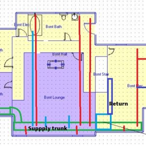

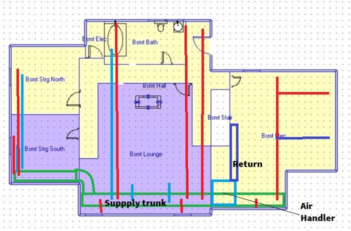

        Akos | | #19
        With a gut job the answer is simple, run the ducts, anything else is a hack.
        I'm in the land of low basements and the way to deal with ductwork is to run it along an outside wall. This keeps it away from any foot traffic and any supply takeoffs to rooms can now run along the floor joists. If done properly, you don't even notice once the trunk gets boxed in.
        See roughly marked up version. Green is the supply trunk along the outside wall. Blue are supply feeds to basement. Red to main floor. The return runs up beside the staircase to the main floor.
        Yes it will block some of the basement windows. Since it is set back a bit, you will still get light. You can also turn the trunk on edge and run it along the wall bellow the window and it won't block anything.
        For the 2nd floor, that is what I meant. I would do all in flex. Simplest for complicated runs, just oversize a bit and keep the ducts out of attic space.
        Missed the attic office. That wall mount there as well. No point in trying to tie it into the rest of the house plus the heat load there will be very different as it is exposed on the bottom. You can put the living east and attic office on a 2 zone multi split.
        By wall mount, I mean standard ductless unit. Ceiling cassette and floor mount are also possible. I would say floor mount is the easiest to maintain but because it is not common, HVAC tech won't know how. Ceiling cassette is the hardest as there are a lot of moving bits in a very tight space.
        1. anonymoususer | | #21
          Thank you, Akos. This markup is helpful. Is it acceptable to have a single return for the entire ground floor? I thought I had to have a duct returning to the handler from each room where there is a supply...? What about the return for attic level: would that run next to the supply ducts going to each attic level bedroom ? Assuming attic space is inside thermal envelope, is it okay to have ductwork there?
            Akos | | #24
            Around me a central return is pretty much universal. Usually in a hallway so it can service the entire floor.
            For any rooms with doors you need a return air path. This can be either dedicated ducting, jumper ducts to hallway or door undercuts. Typical here is door undercuts, if you want better for sound isolation say in the main bedroom, you can do jumper ducts. I see very little benefit to dedicated return ducting.
            For the attic rooms, since the ducted unit is already in the hallway, you can have a short return duct with a filter grill right on the ceiling behind the unit. For the rooms, same idea, either door undercuts or jumper ducts. If your attic is conditioned (that is a LOT of spray foam for that in cold climate), you can run ducting through there. You can also put the air handler into the attic space if you don't want it to take up ceiling height, make sure you think about future serviceability and ease of filter replacement.
