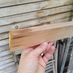

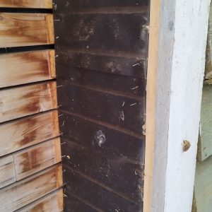

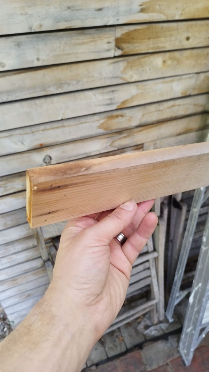

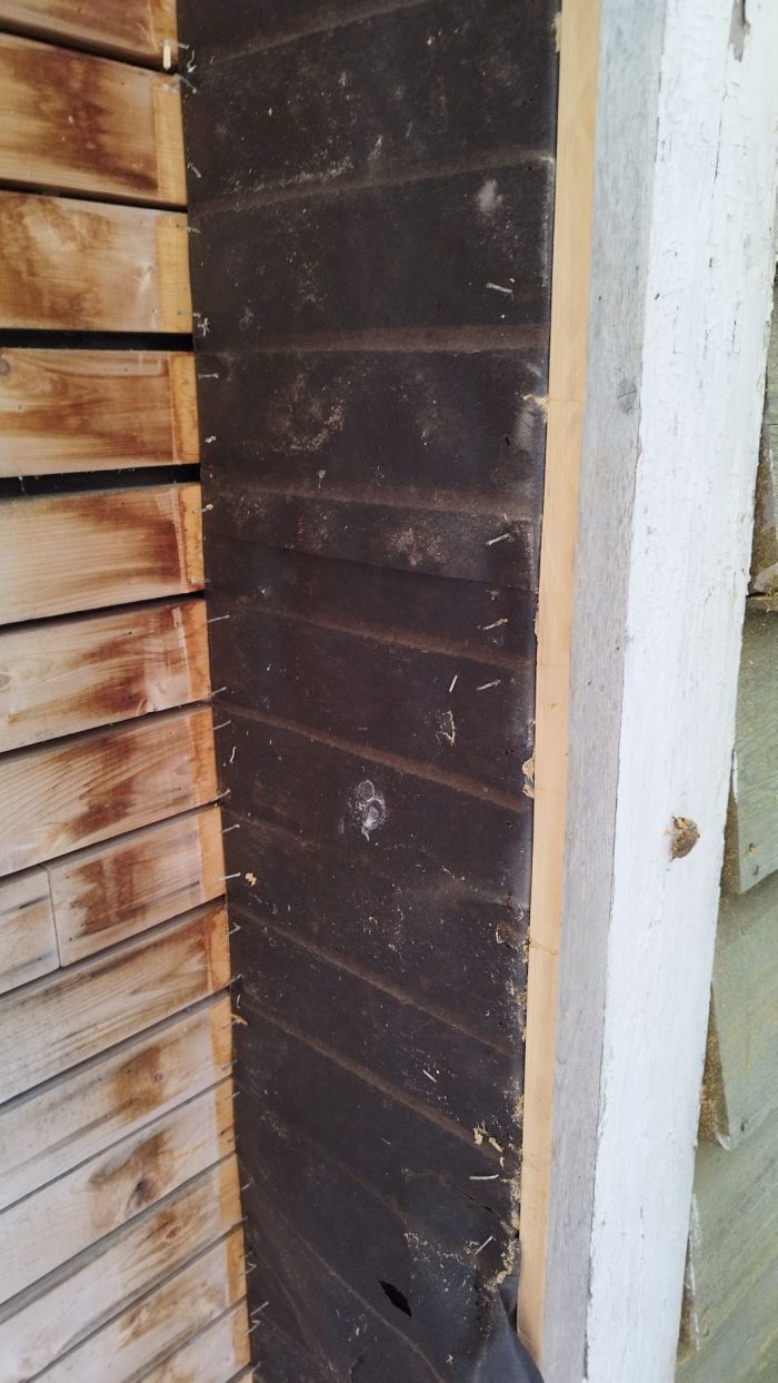

      Sample of 1.
      I built a shed with simple gapped 1x3 horizontal slats about 10 years ago. WRB was 30lb felt, so not anything special.
      I recently pulled off one small section to extend it. I was surprised to see minimal wear. That section had small overhangs (~6") with no gutters for most of its life.
      Still not a fan of open cladding and not saying you should build a house like but I would be less concerned if built over the correct WRB with proper detailing.

          Akos | | #6
          To me the surprising thing was how little water made it behind the cladding. This area was definitely exposed to rain and yet the backside looked pristine.
          So it might not stop bulk water completely but it does reduce it. Not advocating for open cladding, just not as bad as I though it would be.
