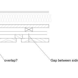

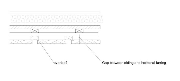

    That being said I'm not sure how the front planks of the reverse batten affix themselves to the furring in this situation? Is there a gap between these and the horizonal furring? And how much overlap should there be for the front plank and the batten behind?

    On a different note, looking at the reverse batten, I worry about the batten stuck against the wall and it's ability to shed water. Would it rot over time. The other issue is that this revers batten takes the place of 2 pieces of furring, so it would have to be at least 2" thick, which might be an issue as I would want it to be the same charred wood as the rest of the finish.

      What are your thickness dimentions for the reverse batten system? I assume ¾" each so your total furring stack is 1½".
      So, if you're worried about wall thickness and you want to get crafty:
      Roll on wrb.
      1" rockwool comfortboard 110
      Majvest UV layer
      ½" hardwood horizontal furring, coated with black tinted epoxy (or also charred as the siding) with the top side cut at a 45 deg angle to shed water out.
      Black vertical siding
      The 1" rockwool and ½" furring would be the same thickness as your original reverse batten plan, and just as robust. Without having water standing on the horizontal furring, and your wrb double-protected with the majvest and rockwool layers.
      Just a thought.
      Jamie

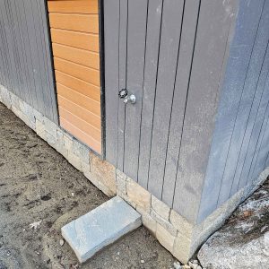

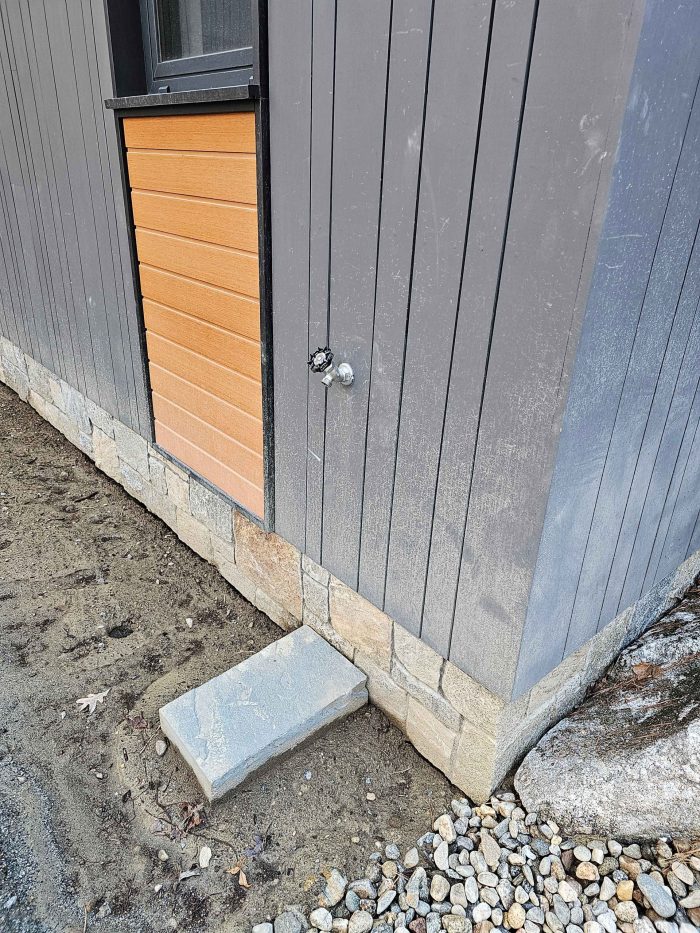

      Brian see my opinions above. I have done a number of these, always successful. The cladding is a water shedding mitigating device. The WRB is the preventative measure, the "buck stops there". Recently we have done 1x Boral boards on a 3/8" Benjamin Obdyke UV batten Strip on Benjamin Obdyke's UV WRB. I have not used the Majvest 700, but we are about to, and I have full confidence in it. I understand people's concerns, but my preference is to trust the science.
  7. user-417066 | | #11

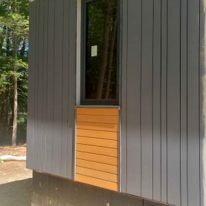

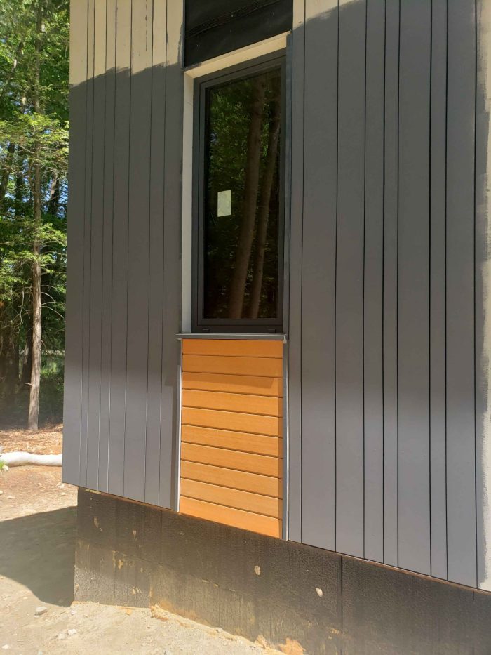

    ARKHOUSE I have done a number of open joint cladding systems, the oldest being over 15 years ago. I like them. I would do it on my own house without hesitation. All of the fears people cite, bugs, mold, rot...etc, are just that fear (and guesses). In fact we recently finished one of the most expensive cladding systems we ever have done and it is a Vertcally oriented board system, on a rainscreen, with Benjamin Obdyke's UV Barrier. It worked perfectly. Like its predessesors, no rot, no bugs, no mold.......While I have done open joint claddings in a horizontal orientation, my preference is the vertical orientation. Here's why - with 3/4" thick boards and a 3/16" space, the space ends up relatively deep and narrow. While I didn't do it, testing experience on other projects would suggest that if I sprayed water on the joint, it would catch the edge of the board and ride it to the bottom. I do not think alot of water is actually making it back to the UV membrane. If it does, who cares? the wall is "air open" and my rate of drying is likely far longer than my rate of wetting. I know many people want to seal up, tape, and caulk all joints. I have seen those homes - because we were investigating them for rot, bugs, and mold. Water management is always a rate question - and an open joint cladding has a huge drying potential - I am a fan!!!! The only park of your detail I would reconsider is the 1/4" space moving to 3/16", I think it simply looks better aesthetically.
