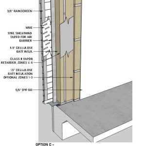

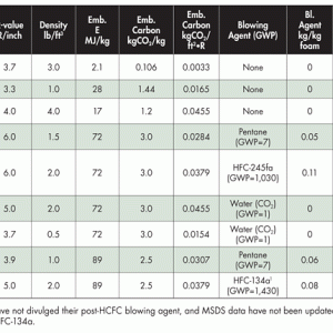

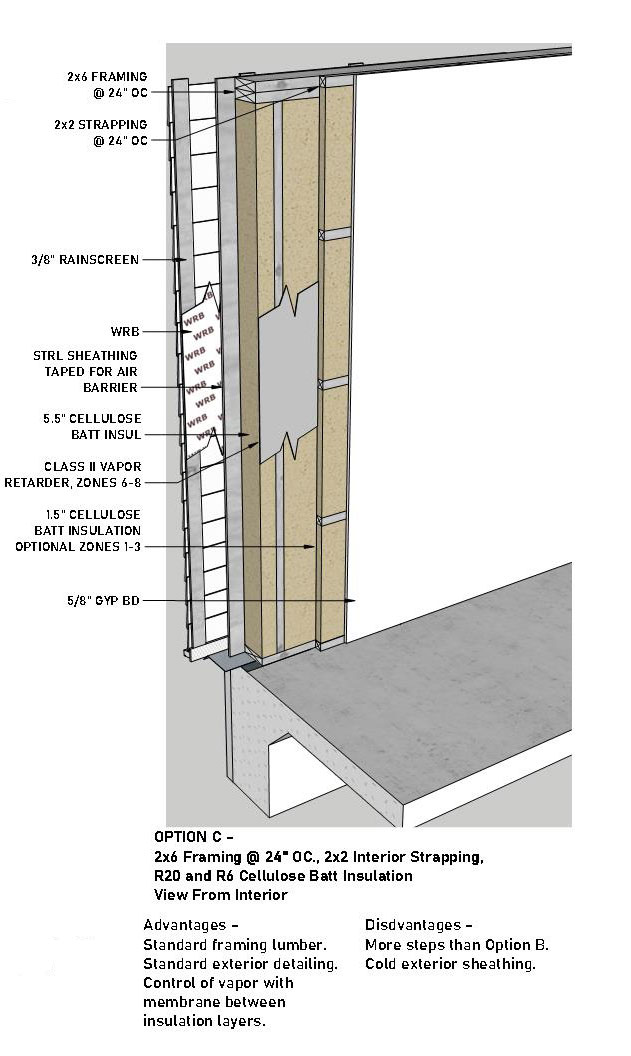

  5. jollygreenshortguy | | #19
    If environmental sustainability is a factor and continuous exterior insulation is a must I would consider EPS exterior (lower GWP than mineral wool, polyiso, and XPS) and cellulose batt or blown on the interior. EPS and cellulose are both very friendly with respect to indoor air quality.
    An alternative that would avoid EPS and exterior insulation would be a Mooney wall with R19 batts between 2x6 studs, and R6 batts inboard of them.
    For improved indoor air quality I would opt for batt rather than blown cellulose, though in either case, there should be no problem if there is a thorough cleanup after installation. If blown, consider giving time before putting up gypsum board, so that the insulation can "outgas" whatever trace of chemicals may be in it. For fire retardancy cellulose is treated with borates or a borate/ammonia combination. Opt for the former. Batts avoid most of this problem because of the time between their manufacture offsite and their installation on site.
    1. matthew25 | | #20
      Can you share a source for that table? Because it seems to be very different from the manufacturer's EPD (environmental product declaration) information. Using A1-C4 categories with the standard reported GWP kg CO2e at 1 m^2 and 1 RSI (which is equivalent to 5.678 R-Value):
      Rockwool Comfortboard 80 = 5.38 kg CO2e/m^2-RSI
      Polyiso w/ Glass Facer = 4.36 kg CO2e/m^2-RSI
      Polyiso w/ Aluminum Facer = 2.32 kg CO2e/m^2-RSI
      So based on manufacturer's provided EPD, mineral wool does NOT have 60% less GWP like your table describes and is, in fact, worse from a GWP standpoint than the two most common forms of polyiso. Rockwool is a good product if you have a fire-resistance use case. I just don't like the pervasive marketing they have done that seems to have swept everybody in this country off their feet without considering their mediocre R-value per inch and their high prices.
      One additional thought: Rockwool's comfort BATT products are lower GWP, maybe your source is using one of those products in its comparison? But since this thread is about exterior insulation obviously we should use their comfortboard product for an apples-to-apples comparison.
