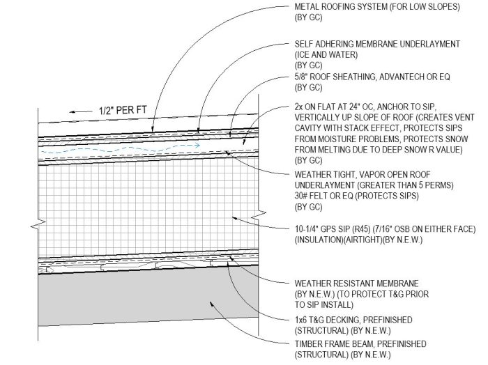

Hello,
We are designing a house in Wisconsin, climate zone 6A, 50lb snow load. The roof and walls will be prefabricated and installed on site. The structure is mortise and tenon Timber Frame.
The roof is a low slope roof (1/2″ per foot). The client really liked this low slope style. We talked with the SIP manufacturer and they highly recommended a vent cavity above. We will be foaming the joints and installing poly under all the joints per the manuf details.
I have attached the current assembly detail (have not done full CDs yet so dont have fascia details). Thinking of a fascia vent to connect to the over vent.
I was hoping for some feedback on experience with venting on low slope roofs and if it actually is less risky than no vent cavity or more risky due to maybe a lack of stack effect. Anyone know of any wingnut type field testing with low slope ventilation? I’ve seen the build show guys do it, but it was on a 2/12 I believe.
Thanks!

    Akos | | #2
    Since it is an over-vent only (not part of an vented roof), your detail should work fine.
    Important bit is that permeable underlayment over the SIP which your drawing shows, just make sure it gets built with it. You show a warm side weather resistant membrane, not sure how that would be applied. Might be simpler to tape the seams of the SIP. The important bit is preventing warm air from getting into the gaps between panels, the panels themselves are vapor closed.
    Metal is possible at 0.5 slope but you have to be very careful because water moves uphill at that slope. All your flashing details need to be perfect and need to be done with sealants to stop this. If you bump up the slope to 2:12, lot of those issues disappear plus you can use a simple snaplock roof panel.
