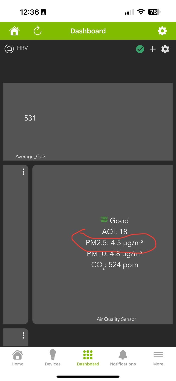

  16. DennisWood | | #31
    I ran a few tests today in the warmer weather. I checked supply (fresh) air flow over the core with a few different filter configurations, at a reference of 110 CFM. The HRV interior filters are completely removed as they are quite restrictive.
    1. Removing the exterior MERV11 pre-filter entirely had less than 5% effect on flow.
    2. Toggling the Carbon canister "on" and adding the MERV 11 outside pre-filter back into system had very little impact on flow. I'd say less than 10 CFM (less than .01"w.g), so about 7-8%.
    3. Removing the warm side supply filter (14x14x4, MERV13) had almost zero impact.
    4. The biggest single pressure hit (other then the core itself) is the PTC heater array. If I leave the interior filter door open (bypassing the heaters) flow increases from 110 to 130 CFM. This is with a 6" ECM fan (AC Infinity CLOUDLINE A6) fan running at 75% speed.
    It would be safe to conclude that if you add an outside/exterior filter box like this using a 25x16x4 pre-filter and the Terrabloom 8" carbon canister (and remove the OEM HRV/ERV supply side filter) you would see very little pressure drop at 110CFM, less than .01"w.c.
    The system rarely runs at 110 CFM as CO2/VOC/Radon levels are kept under thresholds with the system running at 60 or 75 CFM, 90-95% of the time in our home with four occupants, two cats :-) It would be hard to measure any difference in flow at these lower CFM values. I did not test the 25x16x5 MERV16 filter in the pre-filter slot yet, however I would not predict any change as these filters have a lot more surface area than the MPR 1000 and may actually flow better. If using this filter, I'd remove the warm side 14x14x4 MERV 13 filter.
