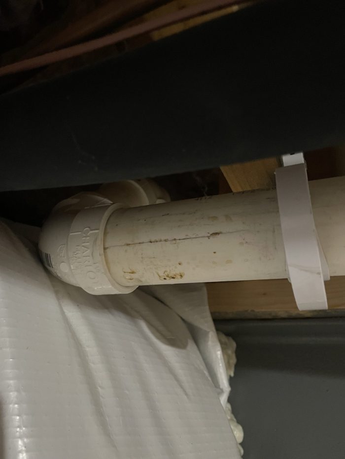

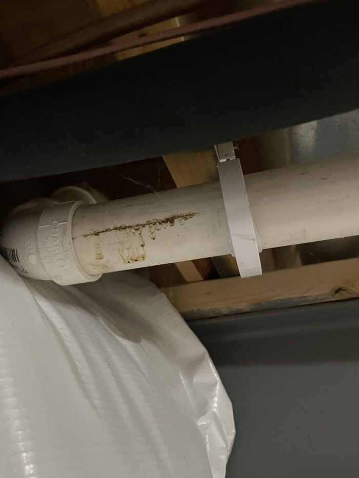

I have noticed this for years and didn’t pay any attention to it but am going to be finishing basement now and wondering if I should replace this before doing so. This is the kitchen sink/dishwasher drain line and like I said hasn’t been an issue for the 4 years I’ve lived in the house. Don’t know if this looks fine or should be replaced, thanks!
    BILL WICHERS | | #1
    That crack looks like it leaked but plugged up with gunk and sealed itself after a while. I would NOT TRUST THAT PIPE. I'd replace that pipe while you have access -- it's relatively easy, and it's cheap to do. You don't want it to fail (technically it already has failed) and wreck your finished basement in the future.

    2. BG57Builder | | #5
      So there are two straight runs (just beyond the crack and then about 2 feet upstream) where I can to cut the pipe. What is the best connector piece to use for those straight pieces? Assuming that is the best route, cutting on straight pipe.
        BILL WICHERS | | #6
        You can't cut the elbow and couple to that, since the dimensions of the bending part of the 90 won't fit other pipe fittings. You can ONLY cut the straight parts of the pipe.
        What I would do is cut to the right of the crack in the picture, being sure to allow an inch or two of good pipe between the crack and the cut line. This helps ensure that cutting the pipe won't just cause more cracking. I would cut above the straight "vertical" piece on the left of your pic. Leave enough room to fit a DWV coupling (which is not as long as a pressure coupling), then use two of those and a new 90 along with some straight pipe to complete the repair. Hopefully you will have enough play in the pipe if you remove that hanger to be able to build up the horizontal part first, and then press it upwards onto the vertical piece.
        If you don't have enough play to do what I describe above, use a "repair coupling" one one side of the repair. Repair couplings don't have stops and can slide all the way onto the pipe. To use one of these, mark the cut pipe 1/2 of the width of the coupling using something like a sharpie marker. Slide the coupling all the way on, then pull the pipes together, then slide the coupling back over the other piece of pipe until you see your mark. This way the repair coupling is centered over the cut line, with about the same amount of glue joint area on both pipes you're coupling together. BE SURE to hold the pipes tightly togther for a bit here since these couplings are not as tight of a fit and you don't want the pipes to seperate while the glue sets.
        BTW, be sure to use purple primer and solvent when making the connections. Clean the pipe well prior to gluing too, sometimes gunk from leaks on the surface of the pipe will prevent the glue from making a good bond, then you just end up with the leak moving to the fitting after making your repair.
        One other thing that might help you out here: Since that vertical pipe looks to be pretty short, you can save some space by using a "street 90" instead of a regular 90. A street 90 has one male and one female connecting end, so you can put the coupler directly onto the 90 instead of using a section of pipe. If you're lucky, the 90 plus the coupler will get enough overall length to fit onto the remaining part of the pipe after you cut things. Sometimes using a pressure coupling instead of a DWV coupling here helps too if you need a little more length. The only difference between the two for this application would be the pressure coupling has about twice as much area for the solvent weld area, so it's a little longer. Use whatever makes the best fit here.
