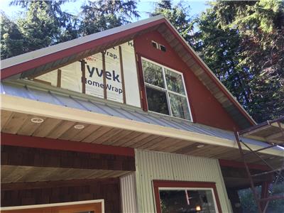

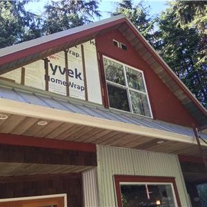

I am wondering what type of rain screen is being used with board and batten siding.  I was looking to use LP siding however on the website it says:  “LP does not recommend panel siding for use over furring strips/strapping, if used it will not warrent buckling.” I was thinking of using watairvent strips…16″oc but now not sure what to do.  Also not sure if watairvent strips worth the cost in general.  Any thoughts?  I’m in zone 6 Maine

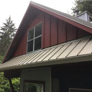

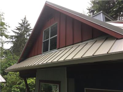

      One big advantage of "sheet and Batten" is the ability to use vertical furring as a rain-screen. I usually use Hardi-panels and trim.
  2. sean1918 | | #3
    So it sounds like board and batten...where boards are 16" wide and 16' long such as LP....and I may do Hardi instead, sound like vertical furring strips at 16"OC is ok...unless I am reading it wrong. Clearly LP would not warrenty it though. Still strange they say to not use it with vertical furring strips.
