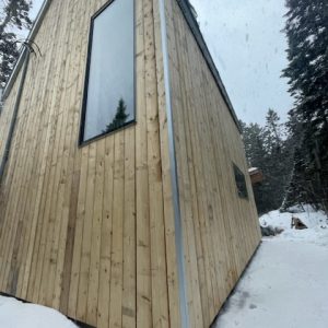

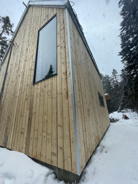

    Hi Stephen,
    I’m in Nova Scotia and have recently put up a reverse board and batten siding for our place.
    I know you plan on installing it horizontally, but here’s a description of what we did in case you find it helpful.
    We put a layer of diagonal strapping for our rain screen, followed by vertical strapping and then 6” wide boards.
    We liked the idea of having more air space behind, but we have friends who did the reverse board and batten just with the vertical strapping behind.
    We spaced our gaps the width of carpenters pencils and put bug screen at the bottom and around window openings. And beveled at 15 degrees the edges of cuts to shed water.
    The advantage of the vertical installation was that we could grow or shrink the boards if needed by either cutting them on the table saw or adjusting the gaps by 1/16th increments to end up with decent sizes at corners and notches for windows.
    Our friends had told us that they had spent a considerable amount of time worrying about keeping the gaps consistent only to find out a year later, that the rough boards had moved. Some swelling, some shrinking. And over the years, they’ve had to go and plug the odd knots that fell.
    We used Stainless Steel ring shanked coil nails for our boards (for a siding nailer) and galvanized ring shanked nails (with our framing nail gun) for the battens.
    The stainless steel nails were quite expensive so we only used them on the last layer and already had galvanized nails leftover from a job. We made sure we were shooting into studs with our diagonal rain screen because of the weight of the following layers.
    I can’t speak to installing it horizontally with no ship lap. Personally, if it was my place, i worry that the air-dried wood would shrink on the south side and you would see your building paper behind.
    It wasn’t the first time we were installing that kind of siding. Local mills sells boards where one side is planned and the other rough.
    I’ve milled last year a lot of T+G boards from rough sawn spruce with a router and a table saw. After joining and planning all the edges for a diagonal solid wood subfloor. I don’t want to know how many passes it took.
    The whole thing took 2 weeks of work and I definitely regretted not paying a local shop to run it through their machines to make the profile in one pass with their shaper.
    Some shops don’t mill anything above 14 percent moisture content through their machines.
    I personally found using a plunge router very helpful for the job. It beats having to set up featherboards on the table saw and you could probably get away without having to join the edge with a jointer that way. It will just ride along the board.
    You’ll have to do it in a few passes per board or you’ll kill your router when the bit gets dull. Ask me how I know…
    Sorry for this huge message! This question sounded very familiar to what I do!
    -Jeanne

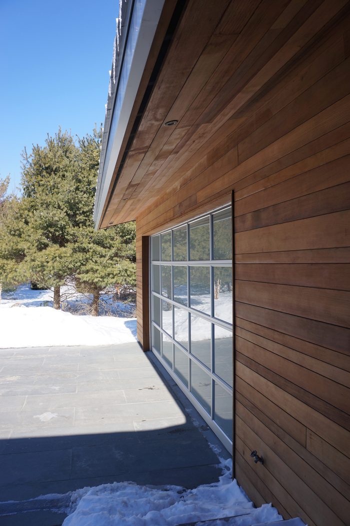

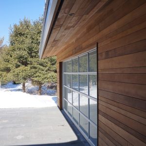

  10. Expert Member
    Michael Maines | | #13
    You can install the boards in a clapboard-like fashion, you just need trim details that are not typical in Maine.
    You can also install the boards on the flat without a shiplap; open-joint cladding works just fine when detailed properly. With a rot-prone wood like red spruce, I would bevel all of the board edges 10-15° and install them tightly together over vertical cedar or pressure treated furring, over a UV-stable, solid black WRB. There is some risk of pests but it's much lower than many people think. Use metal insect screening at the bottom. Venting at the top is less important than usual because the gaps that will develop between each board provide air flow.
