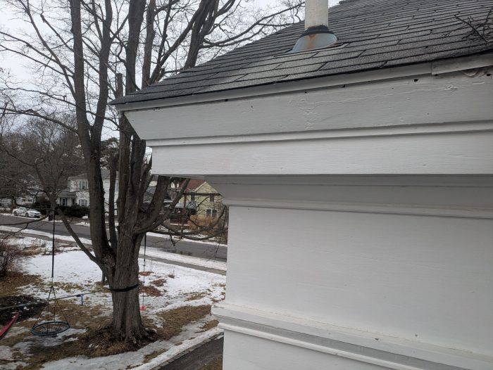

Hey there GBA. I’m an architect and I have a difficult roof situation (on my own house) and could use some advice/reassurance on how to deal with it. This is an existing 1860’s Greek Revival home in Climate Zone 6 that needs a new roof and suffers from really bad ice damming. It has a pretty typical sloping ceiling (8:12 pitch) on the second floor that transitions to a flat portion – straight gable with no dormers. The rafters and walls are both 6″ deep. The walls are insulated to about R21 and the sloping portion of the ceiling is about the same. Unfortunately the roof/ceiling is stuffed with vermiculite (asbestos). Obviously in an ideal world that would all be removed but it’s not in the budget at the moment and the roof desperately needs to be repaired. I am also not too concerned about meeting current energy code since this is an existing building and anything I do will be better than what is there now. My primary concern is about mitigating the ice dams and moisture within the assembly/attic.
The exterior trim details are really nice and make this home what it is so the last thing I want to do is add a super thick layer of exterior foam on top and totally destroy the historic character of this home. I’m ok adding some thickness but not what it would take to make this meet code or ideal insulation levels for this climate zone.

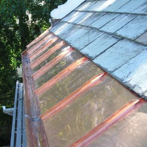

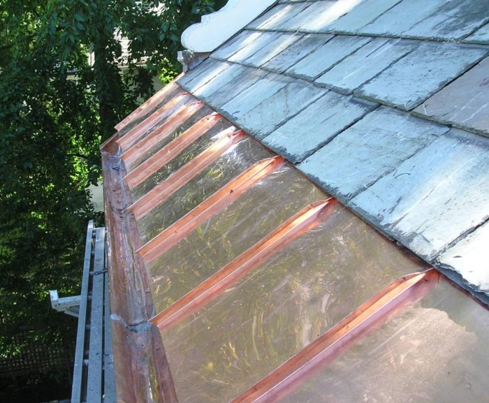

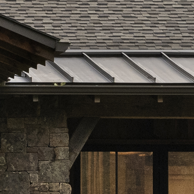

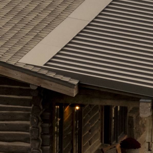

    A common variation of option 3 in my area is to do standing seam for the first ~ 2 feet of roof line and then transition back to shingles for the rest of the roof. It does nothing to address the air-sealing and insulation issues but it does help the ice dams slide off, especially on steeper roofs. It is an idea if you think you will tackle things from the inside eventually.
      MALCOLM TAYLOR | | #5
      strausjw,
      Interesting - I’ve never seen that. How is the transition managed when the roof has to rise over the ribs?
      1. strausjw | | #7
        Hammer the ribs flat, and preferably hem the entire top edge over to create a water check. Here is a picture from google with slate, but its the same idea with asphalt.

          1. paulmagnuscalabro | | #11
            Malcolm,
            I've seen this a few times - very similar but without the standing seams hammered flat. I've always thought of hammering the seams flat at ridges, etc as a Northeast / New England detail, though I don't know if that's actually true.
            In the photos, you can see the standing seam going up and meeting a higher-pitched roof. Not exactly the same scenario, but basically there's a piece of turned-down flashing that covers the seams and gets slit so it can turn down between them. If this was all one roof plane, the standing seam gets accounted for in the framing - similar to how you can account for exposed soffit boards and exposed rafters, where you drop the applied rafter down 3/4" (or rip the top of the actual rafter down 3/4") to account for the height difference.
            strausjw,
            I love the look of that hammered-down copper and the slate. Slick detail!
