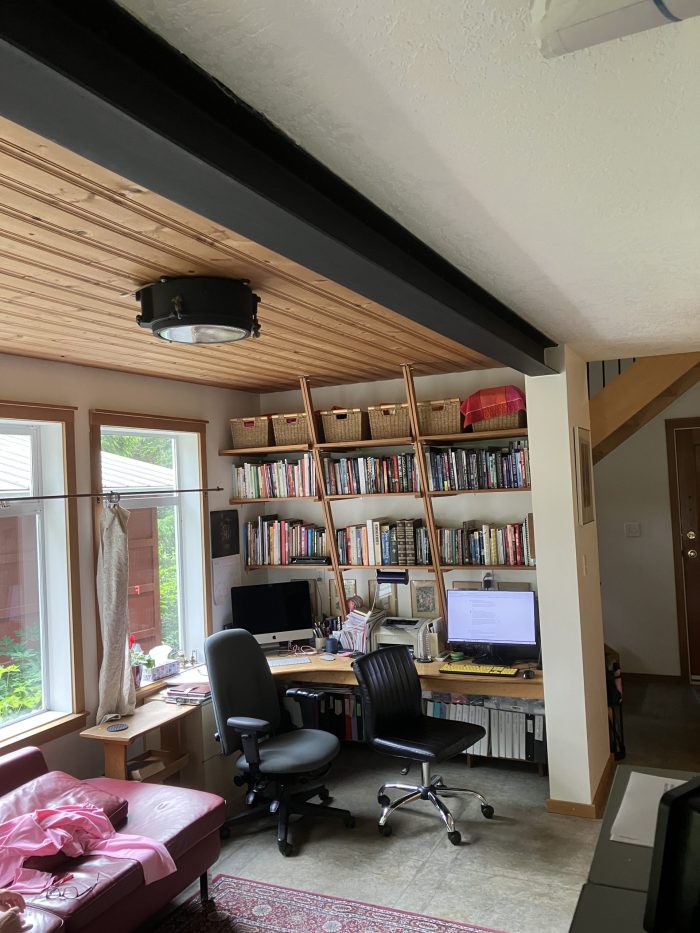

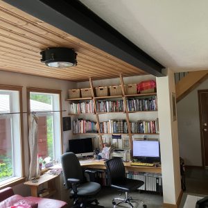

        I've got two intentionally exposed I-beams on my main floor.

          I have a family cabin where we have some exposed steel and I used a rectangular tube for a cleaner look. The reason for steel in my case was to get more stiffness in a reduced depth, since we were working with a low ceiling. We painted ours white.
          BTW, your shelves look like they need something to provide racking resistance. I'd normally suggest a shear panel, but let in bracing would probably work better on a book shelf (hehe) :-D There is an illusion of it leaning in that pic that jumped out at me.
