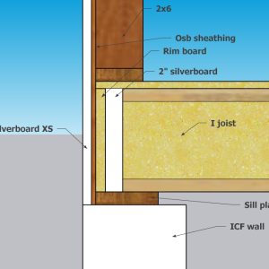

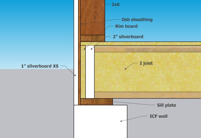

We are in the process of a build using i-joists, and realize that extending the poly wall vapour barrier into the joist cavity is tough with i-joists.
The plan is to use rigid foam board and use can foam around the edges, this will effectively create a vapour barrier correct?
If that’s the case, how would you detail the poly vapour barrier to foam board in the joist cavity? If foam board is used as the vapour barrier can we then add fiberglass on the warm side? If yes, would you use 1″ foam and then fiberglass?

    I think it would be considered zone 6. We need to tackle this in 3 different configurations. Basement walls are ICF, ground floor walls are varied, some are icf, some are framed, second storey above. There is 1" rigid on the exterior
    We temporarily had fiberglass in all the joist cavities, and definitely got condensation and ice behind it.

        The floor assembly sits on the icf, not ledgered. We put batts in the joist cavities for the winter, and got a lot of condensation and ice behind them, which is why I'm asking about adding a vapour barrier in the joist cavities to make it more continuous.
        Our insulation compliance package requires at least R5 on the exterior and R19 in the walls.
        The basement walls will have no ceiling, the ground floor walls will.
        Not sure if it matters, but our exterior insulation is micro perforated.

          Fibrous batts are vapor open and will allow any interior water vapor to move towards the cold wall sheathing where it can condense. Using a rigid foam in the rim joist (as you suggested in your original question) and sealing around the perimeter with a sealant should eliminate the condensation issue in that location.

    For the rim on top of the ICF wall, the ICF wall acts as the vapour barrier, and the 2" foam does as well. Can I put fiberglass on the inside against the foam, or will that cause condensation on top of the sill? There will be no ceiling

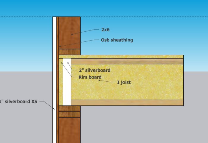

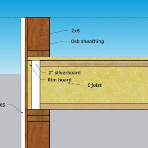

    For the joist cavities between floors, the vapour barrier will end at the top plate, then 2" foam in the cavity, same question with regards to the fiberglass, if we put fiberglass on the inside face of the foam will condensation form on the top plate? There will be a wood ceiling.

      That will work great. You can also stuff some 2x4 batts over the rigid for a bit of extra R value.

        So no concern about condensation on the sill plate or top plates if we put fiberglass on the warm side of the 2" foam? There's only 1" on the exterior.
