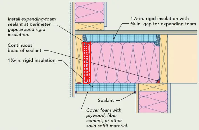

I am currently renovating and taking the opportunity to properly air seal and insulate the cold floor between my living room and exterior carport below. How important is it to add rigid foam to the rim joist of the cold floor? Martin’s details exclude it. I am currently planning to fill the joist space with mineral wool batts and use Zip R at the underside of the floor/ceiling of the carport. Do I need to add rigid foam here, or is the rockwool batts enough? Note, I am not adding rigid foam to the underside of the floor deck – just to the underside of the assembly.

    Neither the foam under the sub-floor, or against the rim-joist is necessary in that section.
  2. afos82 | | #2
