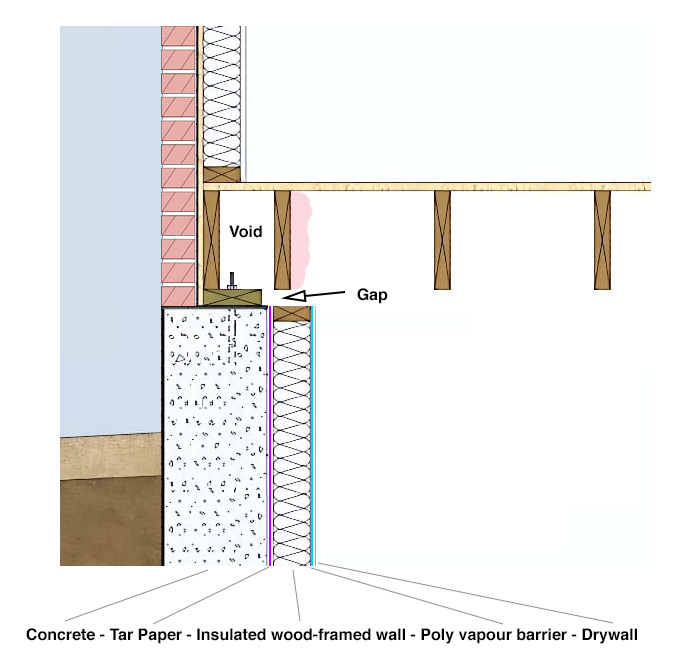

I am wondering if there’s a rim joist insulation strategy I can use in my basement given that my basement walls are already built, “diaper style” by a previous owner, probably 30+ years ago.
The walls have tar paper in front of the concrete foundation wall, followed by fiberglass-filled wood framing, 6 mil poly, then drywall. The sill plate has a capillary break between it and the concrete wall.

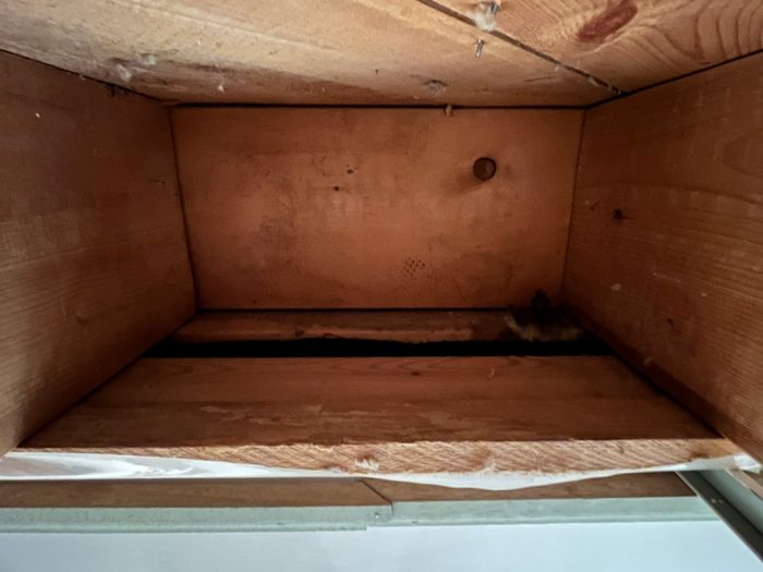

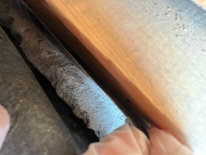

The rim joists are accessible since the ceiling is a drop ceiling. There were paper-faced batts on them before (30+ years old) and I’ve just begun removing them and caulking the gaps in between wood components. So far I have not seen a sign of mold or rot.
This basement is relatively dry in the sense that I’ve never seen water and it doesn’t smell, but it does have high indoor RH in the summer (~70%) for 2-3 months. I have been running a dehumidifier during the summer to keep it in the 50-55% range. In winter the house runs in the 30-40% range.
For the rim joists and end joists, I’ve been thinking of rockwool batts plus a smart vapour barrier like intello plus, taped to the poly from the wall. I’ve also been thinking of 2″ EPS rigid foam, followed by a rockwool batt.

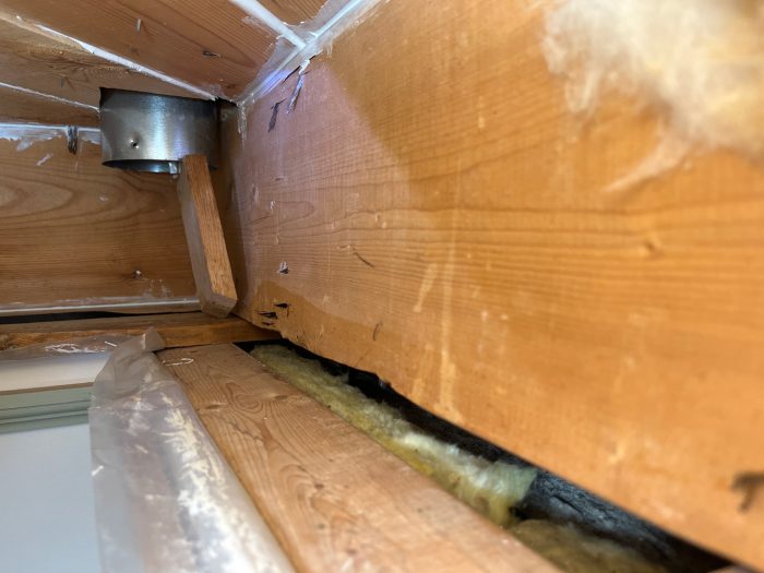

I also have a challenging ‘void’ at the 2 ends of the house which I’m not sure what to do with. I was considering removal of the bottom half of the joist that’s blocking access, so I can do the air sealing and insulation, then sistering in a new joist. But realistically I probably don’t have time for that.

    For the rim joist cavities, after caulking the gaps in the wood components, my current idea is to install R22 rockwool batts and then a smart vapour barrier taped at the top edge to the subfloor, left/right edges to the joists and bottom edge to the protruding poly behind the existing drywall. Looking at using Majrex 200. Thoughts on this approach?
    1. Malcolm_Taylor | | #2
      Tom,
      The advice typically differs on how to deal with rim-joists on top of concrete stem-walls, and those on the floors above. Because of the difficulty of air sealing the former, and the increased moisture which can come from the concrete below, the usual recommendation is to use pieces of foam board sealed into place with canned foam.
      That said, what you are proposing works fine with diligent air-sealing of the membrane in each joist bay.

        Yeah that void is driving me crazy alright! I guess there is no easy solution there. I am wondering if I were to insulate and tape the smart VB over the 'inner' joist if it would create a major condensation risk inside the void?
        1. Malcolm_Taylor | | #6
          Tom,
          I don't see why air-sealing the inner joist and packing the cavity with rockwool wouldn't work. One thing to look out for would be holes up into the walls above for wiring or plumbing you would want to seal to stop them bypassing your air-barrier.

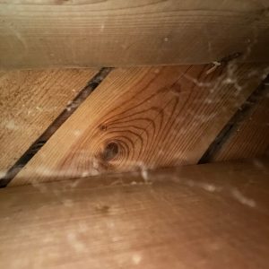

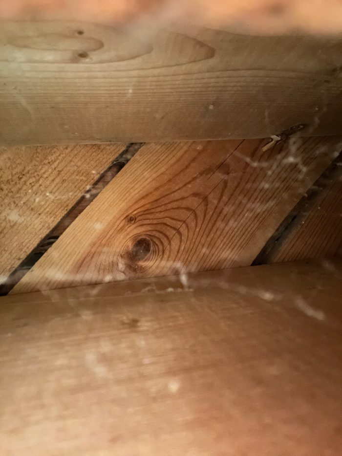

            Yes that is a good point. The void is not really accessible so I wouldn't be able to pack it with rockwool. The subfloor is diagonal plank so there is a chance that the gaps between the planks are somewhat connected to the space above. I managed to slip my phone into the gap under the 'inner' joist to get a pic of the space and the subfloor above... Hoping this might trigger some new ideas!

            Rather than remove part of the joist, you can drill holes without compromising the structural integrity:
            - Holes must be at least 2 inches away from the top or bottom edge.
            - The diameter of a hole cannot exceed one-third of the joist's depth.
            - Multiple holes must be spaced at least 2 inches apart from each other.
            You can then pack the cavity with insulation.

            Thanks Malcolm, I think that would work for insulation! How about air-sealing though? If I just packed in insulation without air sealing, warm air might migrate from above through those diagonal planks and condense on the now-cold end joist. What do you think, do I have a legitimate concern?

      That trouble spot is tricky. I have a few of those in my own home too. The best option for those is spray foam, but even then, it's difficult to do a good job due to the limited access. I've tried the Krakenbond stuff you can get on Amazon for this purpose, and it works, but it's hard to know if it's fully covered the rim joist without leaving a gap down around the mudsill.
      BTW, what is that metal vent pipe? in the back right of the third pic?

        Re: the trouble spot, yes very tricky! What do you think of my idea of slicing the bottom half off of the blocking joist in order to access the void and air seal/insulate the real end joist. Then sistering in a new joist? It seems like a ton of work though.
        The vent pipe is an hvac duct leading up through the corner of the main floor living room into a 2nd floor bedroom floor vent. I had to remove the section of horizontal duct in order to access what I thought was the end joist. The plan is to reinstall that duct, maybe with an insulation sleeve on it, after the end joist is air sealed/insulated.

            For the void, would you drill holes into the joist face at a certain interval and then fill with foam from there? What about cellulose? I am pretty reluctant to use a ton of spray foam. The mudsill is kind of accessible from the crack in this section (see this video: https://www.dropbox.com/scl/fi/zytgk6mumgs2w8tzhtza6/IMG_1460.MOV?rlkey=a2ojy6dxb2fg5czjygmed0nac&st=lupthrha&dl=0). In another spot (on the other side of a supporting beam) the joist is staggered inward so that section will be harder....
