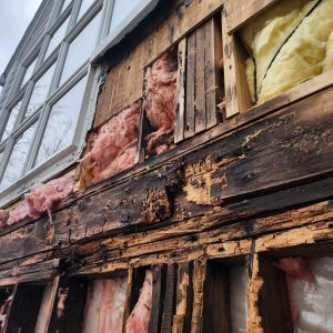

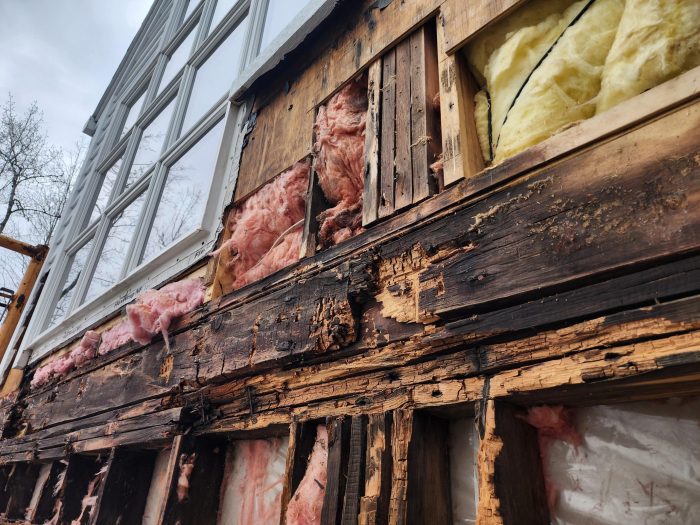

    Usually, we don't replace all the sheathing unless there is extensive damage throughout the structure, at that point, you may also have damage to the framing. I visited a home with these issues last spring. The builder almost didn't open up the sheathing because it looked okay, some staining but intact. He decided to cut open a small area just to peak and found heavy structural damage. My takeaway from this experience, if the sheathing is discolored or feels a little punky, do a little more investigating. This photo shows the home.

    Thanks Randy. Excellent tips and advice. That picture shows incredible damage.
