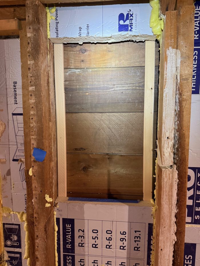

My house is in zone 6 and is 125 years old with old growth true dimension lumber.
I followed the recommended retrofit, cut and cobble, insulation recommendations using rigid foam and 1×2 sleepers in the stud bays to keep the foam off the 1×8 old plank siding.  I even tested it with a sheet of insulation against the siding, then pulled it off and found at least one plank saturated with water.  I then reinstalled with the 1×2 sleepers refoamed and cut it away after 3 weeks of rain, and the plank was dry as a bone. (the exterior is generally very leaky so that 1 inch space (really 3/4) is probably getting lots of airflow
2 concerns I have though.
1) I used Sika poly iso, with foil backing to do the cut and cobble.  I’ve since read that might be a problem due to lack of vapor flow.
2) I had a structural engineer look at the house for other reasons, and he saw the insulation and  was concerned about the impact on the 2×6 exterior wall studs (not the plank sheathing).  He said eventually the 2×6 studs would rot because of the foam.  I’ve not read anything about the impact on the studs when using the cut and cobble technique.  So any information would help.
So wondering if I have to rip it all out and start with a different product.

    The only time the facing of the foam matters is if you don't have enough R value for condensation control. Since you are reffering to 2x6 walls, I'm guessing you are looking to add 2x4 batts behind the foam. In zone 6, as long as the rigid is at least R7.5, the facing doesn't matter as the foam is thick enough for condensation control.
    As for the foam rotting the studs, first time I heard of it. If there is no liquid water in the walls (which should be the case with a condensation controlled assembly plus the vent gap on the outside) there is no source of moisture to rot the stud.
    I have done pretty close to your assembly (real 2x4 studs with 2x2 strapping, so 5.5" space) in zone5 with 1.5" rigid without issues.

    To everyone- the concern on the foam rotting the studs was related solely to vapor infiltration. The concern was that the vapor would enter the stud (depending on the season from inside or outside) and then condense 1/3 of the way in. The outside (both directions) of the stud would be fine, but the middle section would start to rot. This is the first I had heard of this, and wonder if anyone else has encountered this, or heard something similar.
    Many thanks.
      BILL WICHERS | | #5
      Vapor condenses on surfaces. You would get rot on what is known as the "first condensing surface", which would be the face of the stud. Which face would depend on which face was below the dew point of the air on that same side of the stud.
      You can't get "condensation" INSIDE of a solid material. There is no way for that to occur. Condensation has to occur on a surface, since it is, by definition, water "condensing" out of the air onto a solid surface, when the air holds water vapor and the surface is below the dew point of that moist air.
