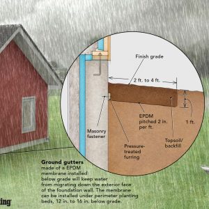

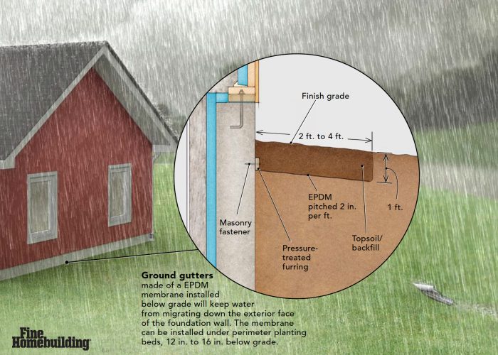

    How's your grading around the house? Code requires a minimum of 6" fall over the first 10' around the building. Directing water away from your foundation is a very good idea.
    Here's a good detail from FHB:
